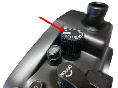

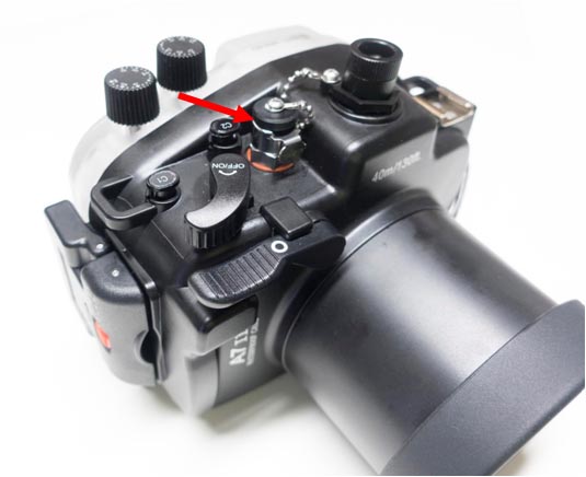

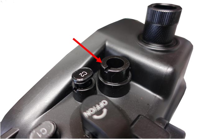

  1. The Meikon case for Sony a7RII does not have a vacuum valve for leak testing. I fitted the Ikelite valve from their IKE-47012 kit by
    milling off the turret for the non-operating mode dial. A first test with the housing at 1/3 bar vacuum overnight was good.
