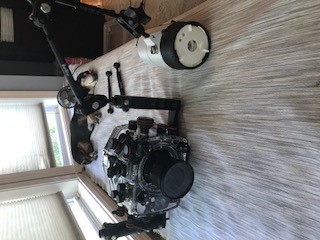

  1. Hi all. After 14yrs of diving, Ive finally gotten a proper housing for my Nikon D300. Ive tested my rig and everything seems to work well with the base set up and Im trying to prepare for a trip to Guadalupe island in Oct. I live in Indy so Ikelite is a 15min drive and Ive had them go through my strobe and housing to check everything out for a clean bill of health. My issue Im sorting out is with the strobe arms. It seems no matter how tight I try to get the knobs, they still dont stay put. The ball joint set up keeps allowing things to move and drop down. Is this just because Im on land and its too much, is it a bad set up or just classic user error? Any suggestions or tricks would be greatly appreciated.
    Thank you
  2. Yes, on land, the strobe's weight on the far side of a very long lever just exerts too much force on the ball joint. Put it in a tub or a pool and you'll see radically different behavior.

    Ok perfect. Thats what I was hoping the case was. Thank you much!
    Adam

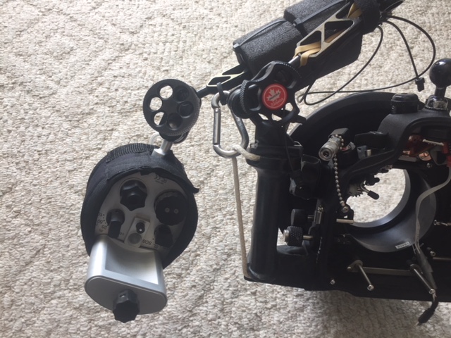

    Do u have a picture of your carabiners and the line setup?

    Here's a quick snap. This isn't the ideal way to rig it for this purpose, but since I switched to optical sync I've taken to mostly carrying my strobes separate, including on my weight belt until I'm in the water. This carabiner position works best for that.
    Aquatica handles have a pass through hole in the center which is great for the loops. They also act as hand straps (much easier to shoot one handed) and points to mount a shoulder strap for carrying longer distances.
    Also shows the new vs old aquatica clamps. New ones (with red logo) are fantastic. Very smooth.
