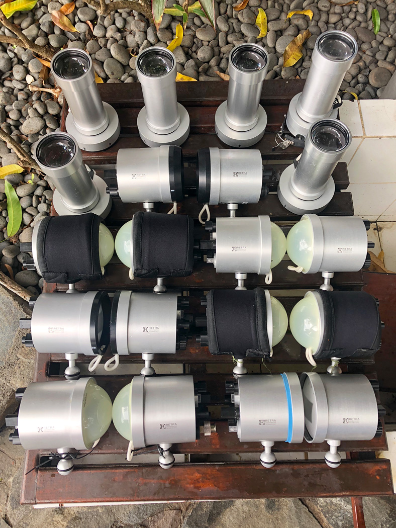

  7. It is the best combination for the LSD - unsurprising as both are designed by the same company. Here is a photo from the recent Wetpixel workshop I ran in Lembeh:
    I find the bayonet mount for the different diffusers and rings a bit stiff on my Retra flashes - but it's strength makes perfect sense when using the LSD.
    Alex
