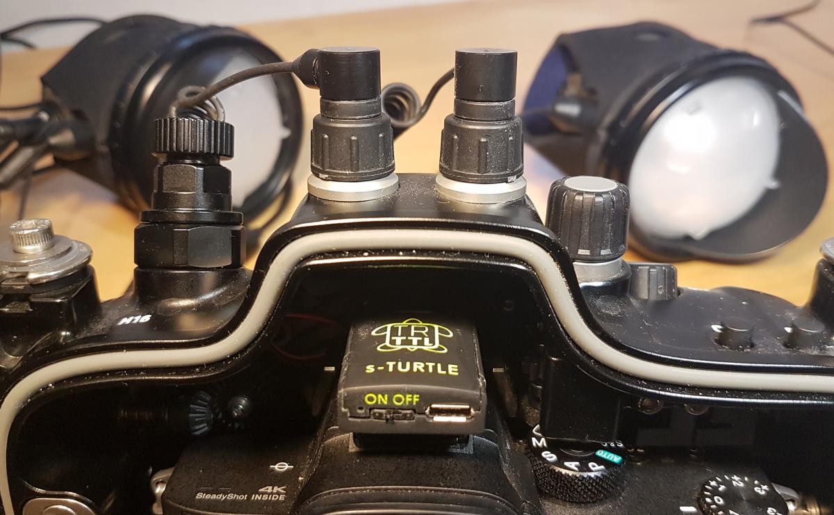

  2. Hi Davec1302, I use with 7rIII. It's not just perfect in TTL and Man, but also pretty :laugh:
  3. Ah, at last, a Turtle user. Thank you for the reply. I hope you have the time for a few questions.
    How long have you had the Turtle and roughly how many shots? Any issues or strange happenings?
    Is the battery life sufficiently long for multiple dives?
    Were those two fiberoptic ports supplied with your case, or did you add them?
    Which brand strobe are you using?
    Any comments appreciated.
    Dave

    Dear Dave,
    The TURTLE can works approx 30 dives. At the last may we werein Bali and we take 200 pictures /dive and 4 dives/day.
    The TURTLE was charged only two times at two weeks. If the Turtle battery is 20% the red led at the back is blinking.
    We tested the TURTLE Sea and Sea, Inon, Nauticam and 10 Bar cables.
    The strobes:
    Inon series, IKELITE Ds 125/160, Sea and SeaD1, D2 ,SUBTRONIC etc.
    If you have any question, just write me.
    support@trt-electronics.com
    Regards
    Balazs
