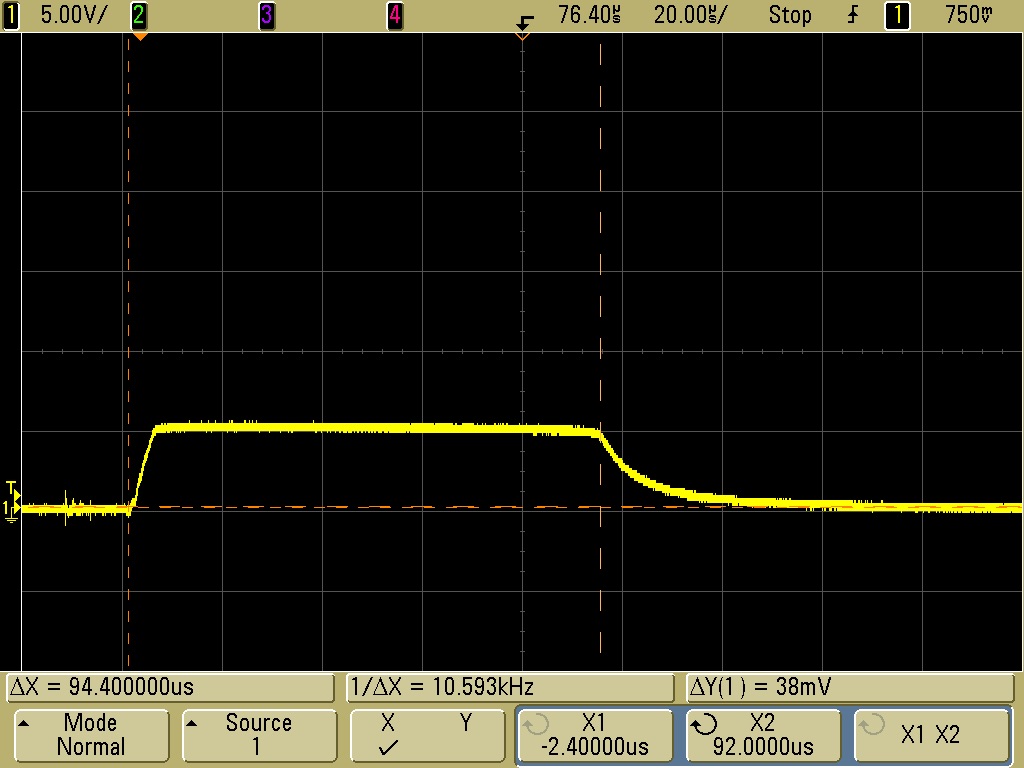

  4. Yep. Pretty sure they're correct. For example, here's a scope plot for @ -6.0. The photodiode saturates, so I can't take 0.1T measurements where the duration is specified as on the rise at 10% of maximum brightness right through to falling at 10% of maximum brightness.
    I guess I could put the photodiode a larger distance away from the flash...
    Bevan

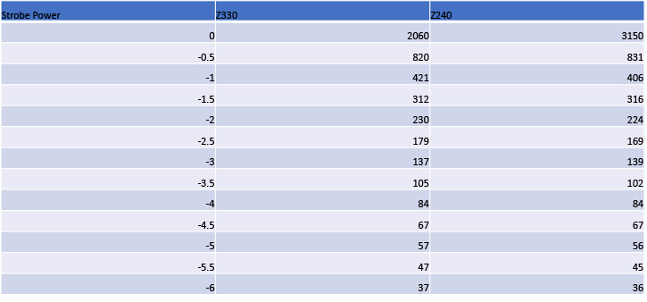

  7. thanks, these look very close to my measurements on the z240 using a slightly different set of hardware.
    Bill
  8. Cheers Bill, It's interesting to hear the Z240 numbers are similar. I'd be curious to know just how similar.
    Bevan
  9. Reply:
    Now you have made me go back to the lab and get a notebook. Will post some numbers soon
    Bill'

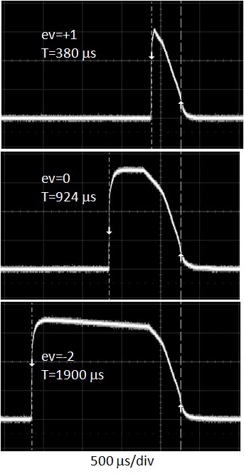

  14. Bill,
    Thanks for the data.
    My main interest is in TTL. I understand that for various cameras, the first TTL pulselength can be different as well as the separation between first and second pulse. For my RX100iv setup, for example, first pulse is always 300 microseconds long and pulse separation is always 78 milliseconds.
    The kind of data I'm most keen to get is second pulse duration for TTL with different scenes that would require short pulse (high scene illumination) versus long pulse (low scene illumination). The way I get those extremes artificially is by setting the camera for low f/number, high iso (high sensitivity) and for high f/number, low iso (low sensitivity).
    Below is the type of data I've taken so far for the a7Rii, manual, and different ev settings. I'm hoping to get the same kind of pulselength extremes in TTL.
    Edited by davec13o2
