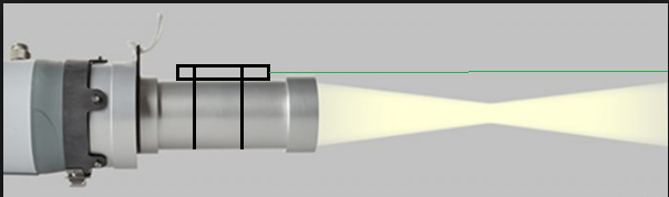

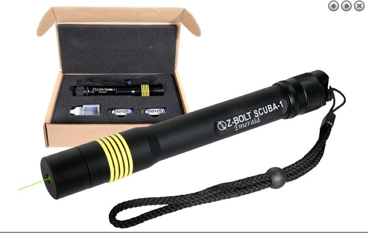

    I was thinking of adding a zbolt laser pointer to a retra lsd. I would use two circular sections of bungee cord to secure the pointer to the barrel of the snoot (see below). I was hoping this would aid in aiming and cut down on the frustration factor somewhat.
    Any thoughts?

  3. I would think the biggest frustration factor with this would be keeping it parallel to the snoot. Two circular surfaces in contact won't necessarily align and the fact that both items are stepped could cause problems as well depending on the length of the straight section available.. I would think that something like this would be more generally useful:

  4. As shown in the image you added, the laser doesn't point at the centre of the retra beam, so I doubt that this would make life much easier.
    I agree that it sometimes can be though to get the aim correct, specially in the bright tropical shallows. Makes you wonder "did I even turn on the strobe" at times :crazy:
