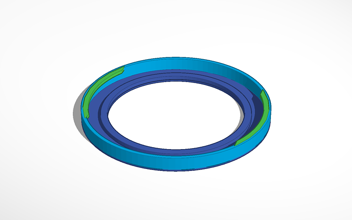

  7. I 3d designed and printed a gel holder for the 14-42mm II for exactly the magic filter, to enable you to use it in the 29mm port.
    https://www.tinkercad.com/things/2dlEK40xkKQ
    t725.png?rev=324&s=8570a11b13a725e13ae44
    It fits like a lens hood, but has a lip on it to hold a circular cut magic filter.
