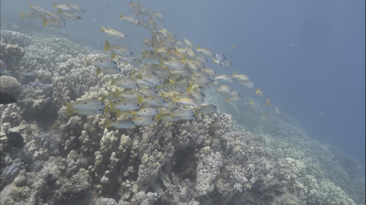

    Balancing and setting a stage for grading
    Look at this examples
    The first is in camera the second is with the LUT untouched and the third is white balanced after the LUT

    The purpose of a LUT is to correct the camera hues (the panasonic colors are off) and conform to a calibrated rec709. In addition the LUT using the correct exposure maximises the dynamic range without loosing the details
    Why spend 15 on a LUT? It saves time you apply it in bulk to the footage and is reversable once you have spent $5000 on a rig spending an additinal 0.4% is insignificant.
    If you look at this footage that was white balanced in water you can see in the first image that colors are off the GH5 has introduced a magenta tinge despite the white balance on a slate. In the LUT rhe tinge has disappeared then you can further edit it or rebalance
    I am talking to Paul Leeming to see if there is a way to produce a cast killer LUT
