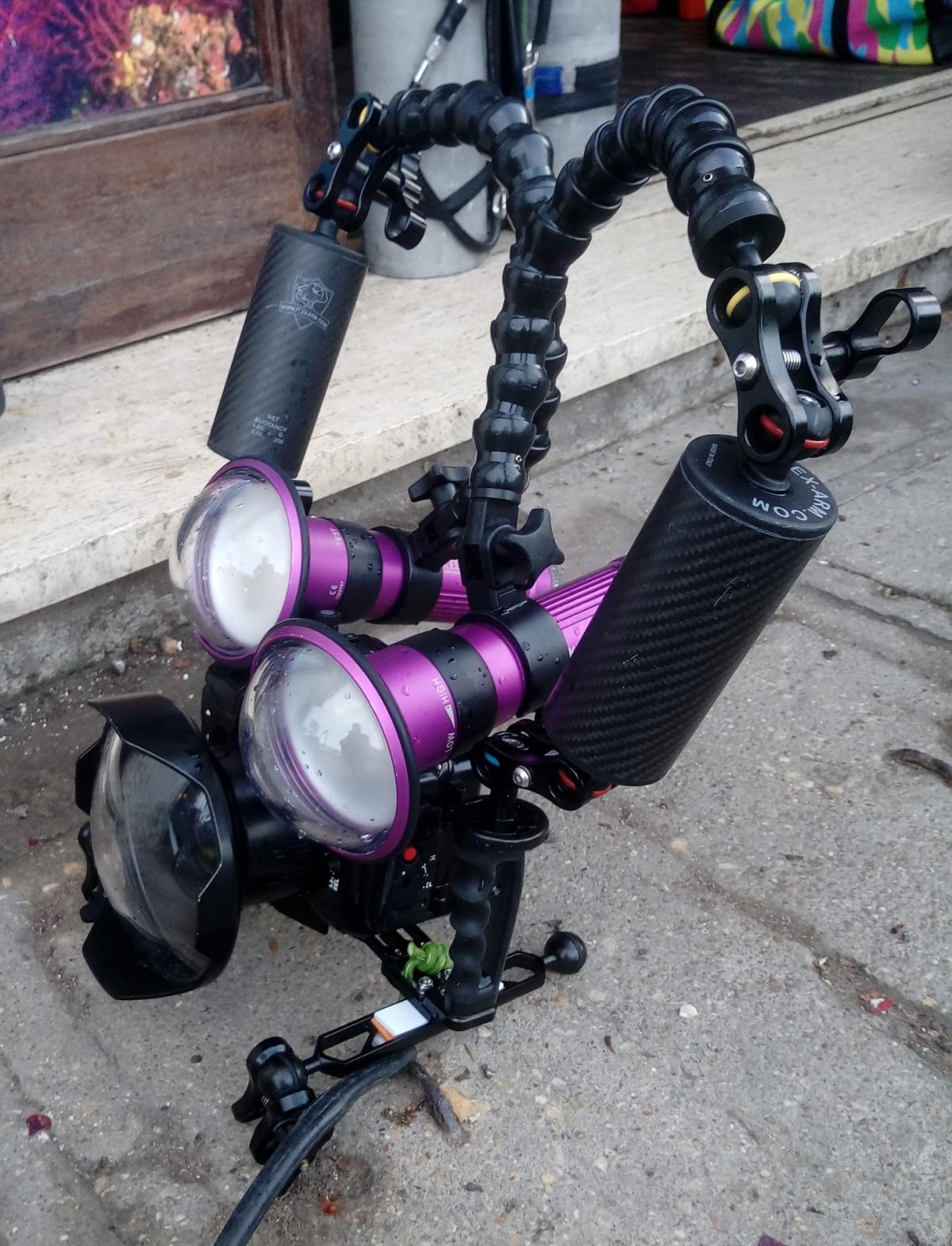

  5. This is my current setup (minus lights)
  6. This is my current setup (minus lights)
    this looks 8 + 8 or in Nauticam terms 200mm?
