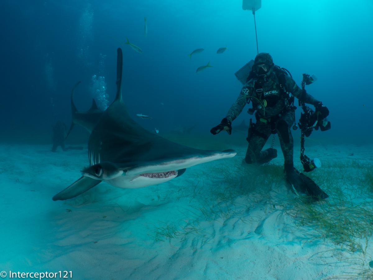

    I have just come back from a trip to Tiger Beach and I have used a red filter on the lens together with ambient filter (I had to make some) on the strobes and the combination gives deep colour and fantastic results look for yourself
    40455082643_8ea5d763f8_k.jpgLooking at me by Interceptor121, on Flickr
    The filter colours penetrate deeper than the strobe and the results are great obviously you need to calculate exactly what filters you need so it is not for everyone

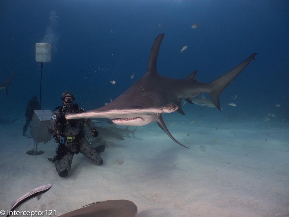

    For comparison this is a picture where there are no filters involved and I have warming diffusers on the strobes it is still great but I like much better the one with the filter
    47367887272_d79137d36e_k.jpgDon't leave me by Interceptor121, on Flickr

  2. Nice work :) I think this technique is actually more effective with strobes for photos than it is with video lights since strobes put out a lot more light and thus aren't as sensitive to the light loss from sticking blue filters on them. Odd that it didn't really catch on for wide angle photography yet somehow is suddenly all the rage for video..
    Curious to hear what you ended up using for blue filtration on the strobes and how you did the calculation.
    Also, shouldn't this theoretically also work in greener water if you combined 'green' filters on the strobes with a magenta filter on the camera? Same principle -- magenta filter helps with white balance to the ambient conditions, and green filters bring the color temperature and tint of the strobes into the same ballpark as the ambient light filtered by the temperate waters?
  3. Looks like a great shoot, though I'm sot sure I feel about the subjects tasting my strobes. The first image definitely has nicer looking water. Looking at the images on my monitor, the second image has a lot more green in it and removing that in post has the effect of darkening up the water column bringing it much closer to the first image in overall look, and the shark will also be closer in tone to image 1. There are other subtle differences still there such as image 2 have more cyan cast to the sand bottom than the first image. The adjustments to use would be a levels adjustment by channel and a green curves adjustment layer, I could post a rework if you were interested to compare.

    I could do those changes but that’s not the purpose here. I don’t think the second photo will win a competition so I left it al naturale
    The issue is that without a filter the colour rendering is worse when the camera does a white balance it averages everything and the hues are gone
    With the filter I white balance before the shot and when I correct all the hues are in the right place which is brilliant

    The technique works in every condition however you need the correct filter on the lens matched by the appropriate filter on the strobes
    For example in green water you would have a magenta filter on the lens and a green filter on the strobes
    To complicate things further there are subtle differences at depth in terms of intensity required
    The complexity above and the incorrect belief on raw formats make this technique rare but raw is not the solution to everything...

  14. Nice results. Can you share how you did the calculations? I'm assuming the goal is to correct both to roughly half way between the strobe color temp and water color temp and set the camera to that?
  15. Nice results. Can you share how you did the calculations? I'm assuming the goal is to correct both to roughly half way between the strobe color temp and water color temp and set the camera to that?
    Am going to do the write up eventually
    The way it works is you get the predominant water hue colour and calculate based on depth at some point however this plateau
