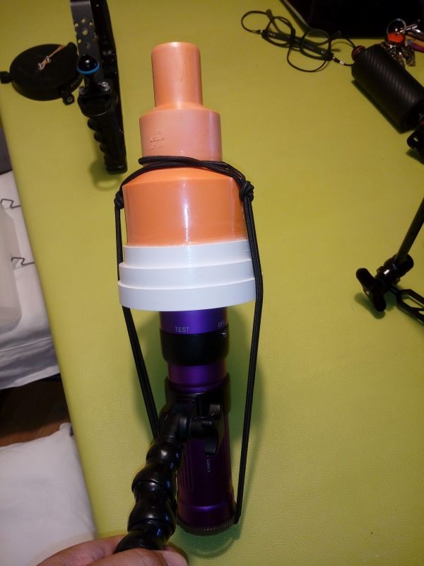

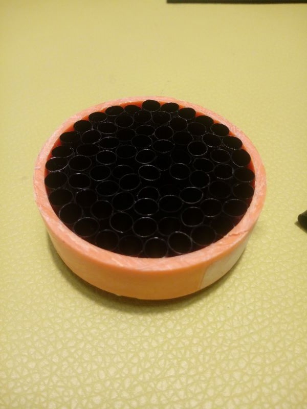

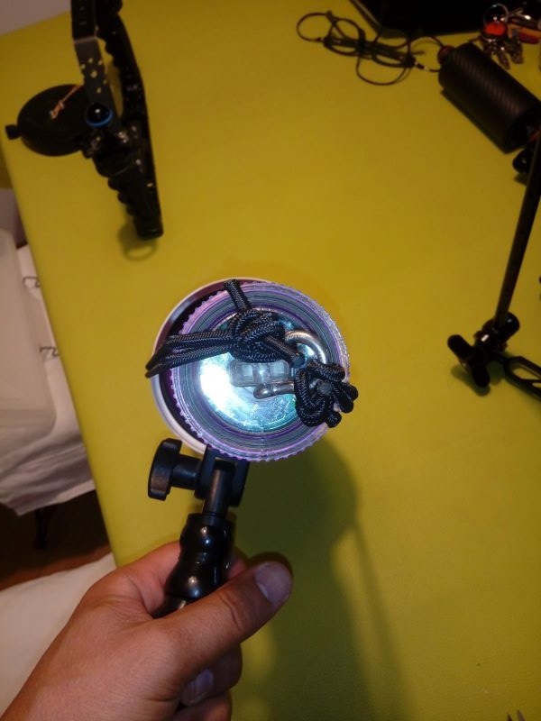

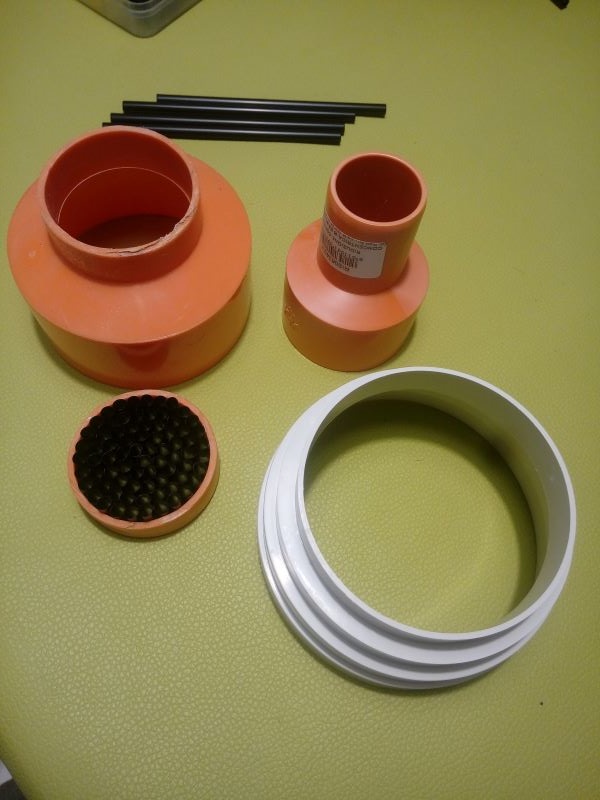

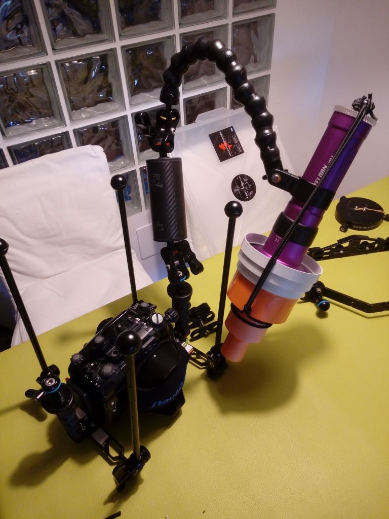

  3. I needed a snoot for my Keldan Luna 8 lights so last year I started for fun a small DIY project.
    In the end i bought two small lights specifically made for macro. My Luna 8 are huge and they have large reflector so the whole "thing" was a benemoth.
    On the other hand i guess that for a strobe it should be a fairly simple DIY project. The best option nowadays would be using a 3D printer but a quick visit to a hardware store could be the fastest route: basically you have to be lucky to find a pipe of the correct diameter for your strobe.

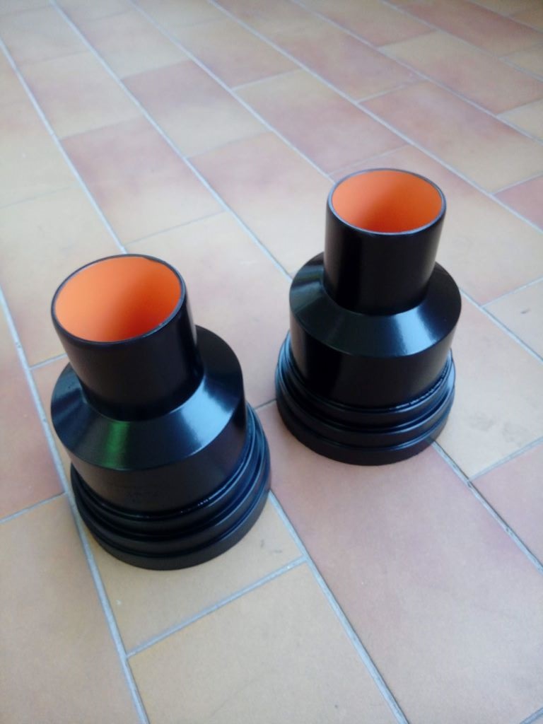

    I share some photos just to illustrate steps involved. I used PVC plumbing pipes (there are standard diameter reductions) and a white kitchen range hood pipe that had exactly the same diameter of my Keldan Luna 8. The snoot had a snug fit but I added some bungee for safety.
    Finally I painted it black for a sleek look :)
  4. Davide's looks pretty much the same as mine - I even painted mine black too.... :crazy:
    The two orangey coloured PVC pipe bits were, I found, the key thing. As Davide says, available at hardware stores.

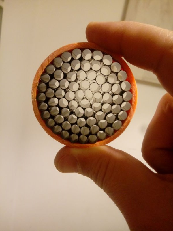

    A good look is the rule #1 ;)
    I don't know if honeycomb diaphragm is really necessary for photography...

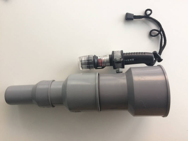

  6. Thanks for your response! I will try to get a better connecting part with a 3d printer. Here you go with my laser-construction:
    Edited by LastAdventures

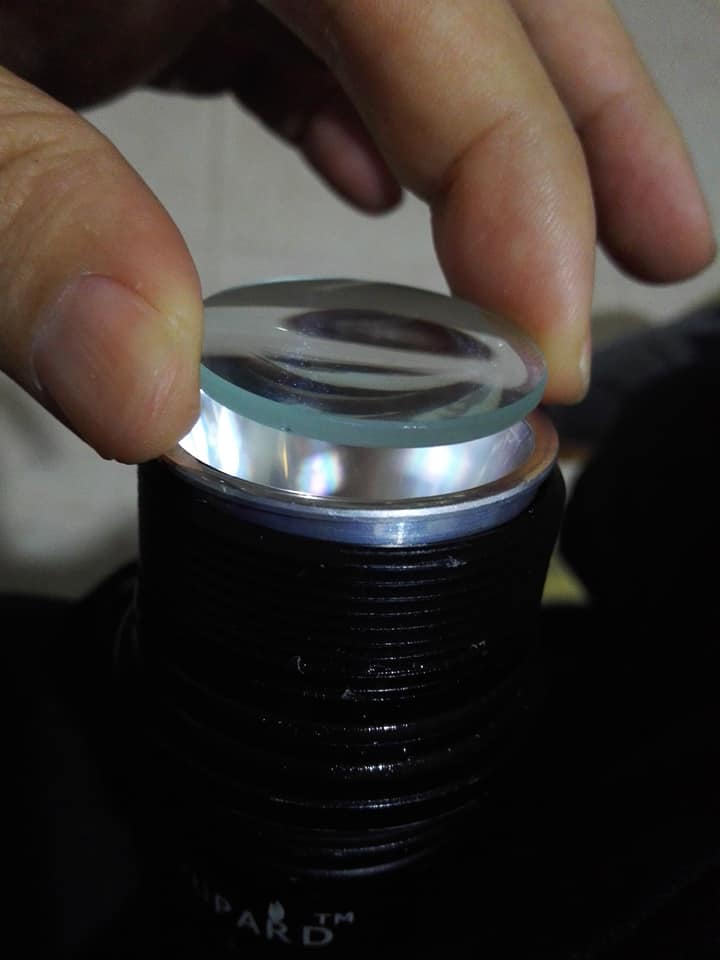

  11. Anyone ever try making a Retra-like columnator with pipe and lenses?
  12. post-70299-0-91483500-1562508263_thumb.jpgpost-70299-0-04901400-1562508269_thumb.jpgpost-70299-0-70972100-1562508274_thumb.jpg
  13. You can't just post these pictures without any explanations... I've just done a 3D printed design for a snoot for a Weefine Smart Focus 3000 lamp, but it seems to eat an awful lot of it's power... Would be very interested in finding out how to DIY an optical solution that reduces the power loss.
  14. Convex lenses converge light. Convex lenses must be placed in air, not in water.
