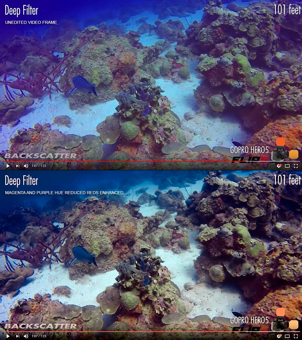

    Found this newer Flip Filter example! The magenta hue from the Deep filter can be easily corrected, shown below:
    GoPro + UW filter + color adjustment = results shown here at 31m (101')! Shooting RAW will get better performance for photos!
    GoPro users are smart enough to understand UW color dynamic and capable of making decisions whether this is good enough for them or not!
    Edited by A.Y.
  14.
    Are you on a commission scheme from backscatter? You may be lucky and live in Bonaire and dive that spot everyday but majority of users will see a very different scene at 100 feet.
    Extrapolating a single ideal example to sell a product for general use is not a good practice and frankly misleading
    And no majority of people do not makes smart decisions especially using a device that does not even provide an exposure meter is almost impossible to take good decisions even in water and that is why the larger part of the clips at those depth look poor just with a filter but obviously this is not what those who sell you the item will tell you
    If you see what magic filters or keldan tell you you get the real view while the gopro market aimed at leas experienced users is more a wild west
  15. Are you on a commission scheme from backscatter? You may be lucky and live in Bonaire and dive that spot everyday but majority of users will see a very different scene at 100 feet.
