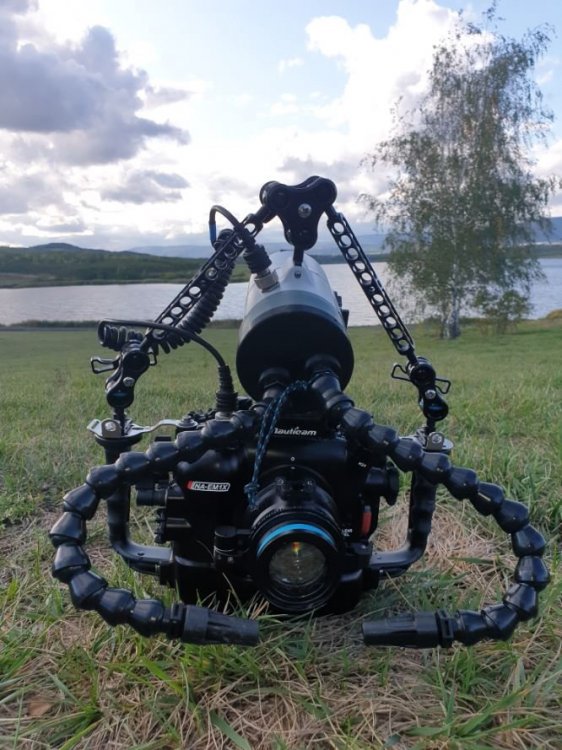

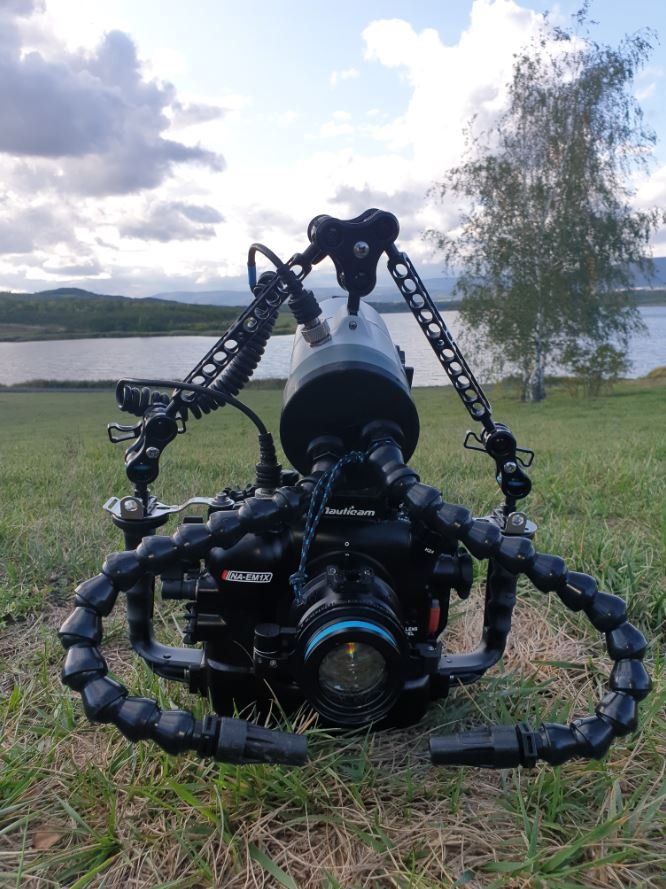

  4. I have one and I’m happy with it. I’m using TTL-Converter from UW Technics. There is some problem with TTL via fiber optic to Ikelite strobes (DS160 + ikelite RC1). TTL by wire works very well with UW Technics TTL-Converter.  Fiber optic TTL works well with FL-LM3 in the housing and RC1 on Ikelite DC160. I’m very happy with results of EM1X and 7-14mm f/2.8 or 8mm f/1.8 for the super wide shoots. Just now I’m trying 60mm f/2.8 for the macro and 60mm +CMC1 for the super macro. But I’m not so happy with the video quality.  I think that EM1X is worse than G9/GH5 or even in some aspects worse than old GH4 for the video. NA-EM1X housing is simply great and I love it. EM1X speed, customization and autofocus are superb. The quality and ergonomics of the NA-EM1X is outstanding.
