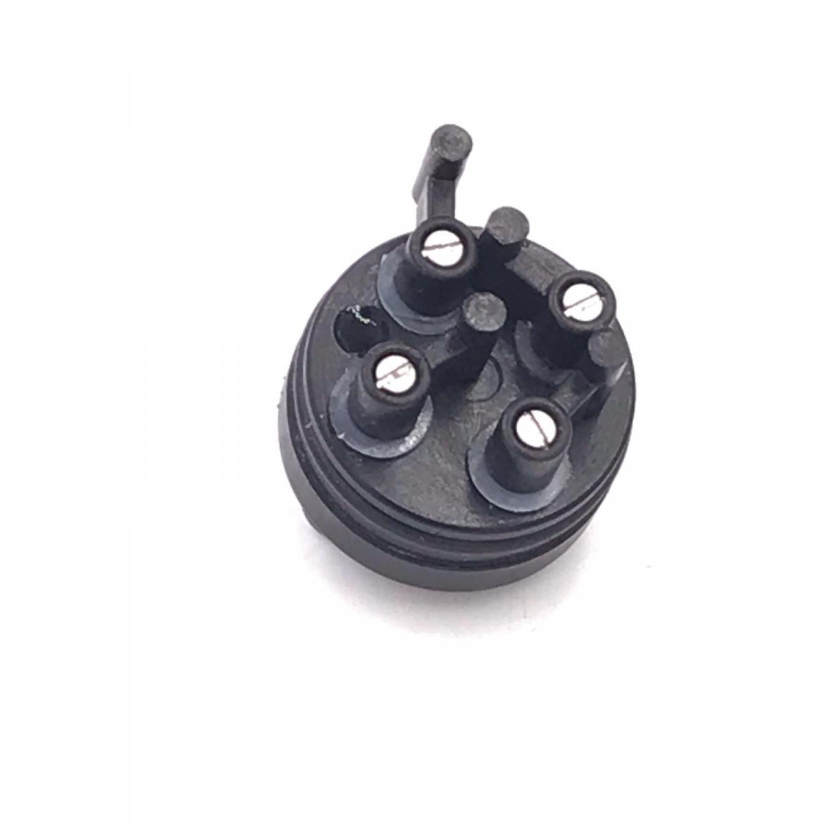

    ​A friend of mine / client purchased a brand new D800 for a real bargain a year ago but was unable to use it due to work. Only this year was he able to test the system and on his first dive, he reported that there was a leak in the housing. After returning the housing to me, I tested it in the chamber and found that after 8m, water was indeed leaking into the housing from one of the push button assemblies on the top left of the front housing.
    Needless to say, for a new housing that was not used, I took the conservative side and changed the o-rings on the push buttons assembly and tested it again. Alias, that did not work and this time I in the chamber, I was certain that the module that was holding the push button assembly (as seen in the photo) was leaking from the screw mount that holds the extenders in position.
