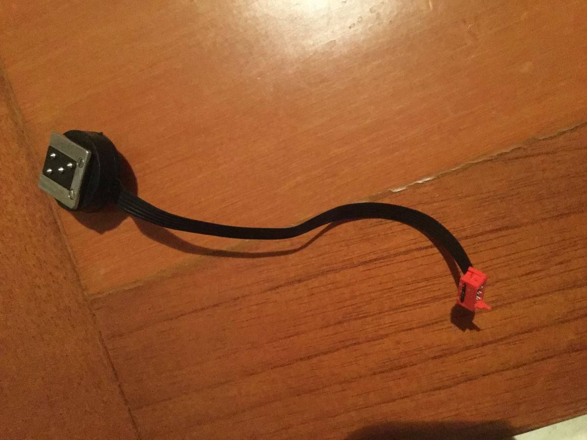

  5. This is what the Nikon one looks like, Tom
