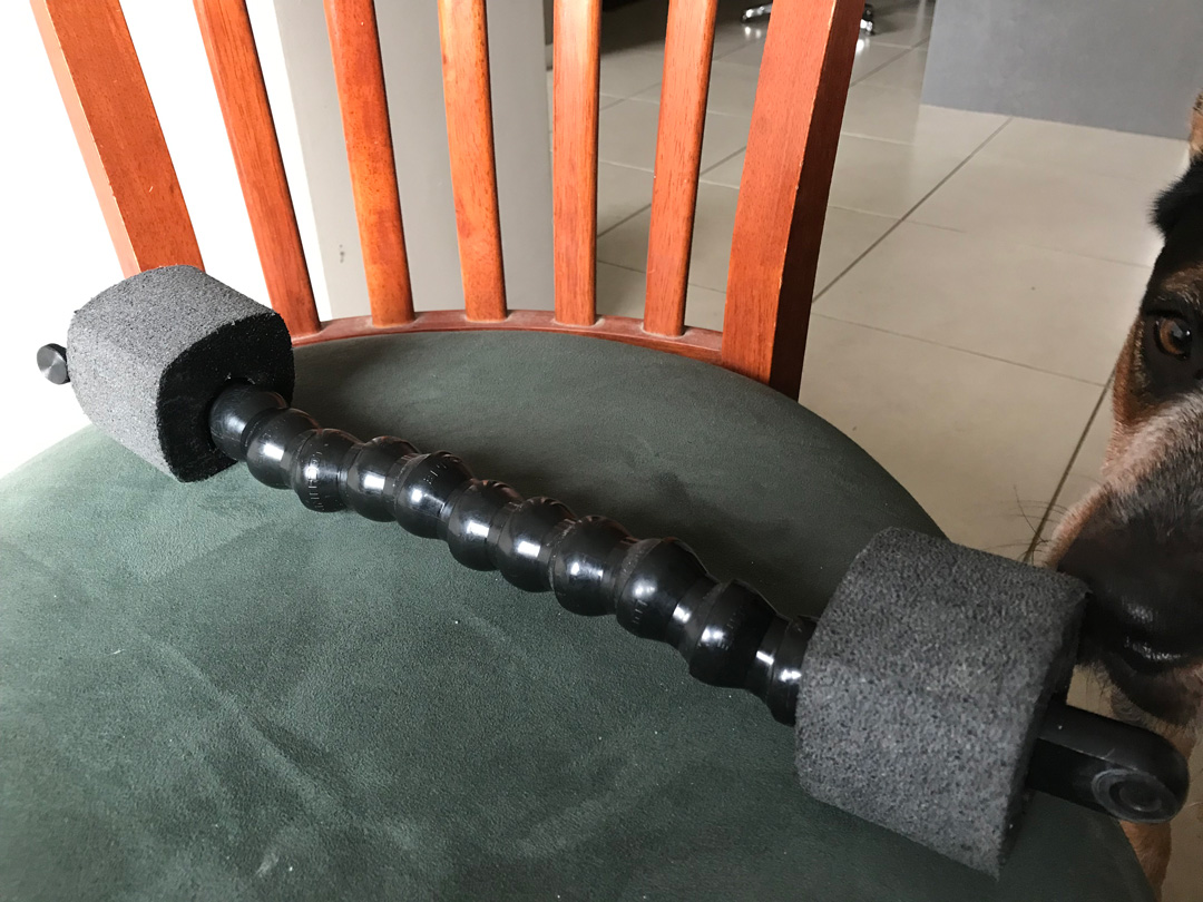

  3. Stix floats for UCLS arms work fine on 3/4 inch Locline:
  4. Stix floats for UCLS arms work fine on 3/4 inch Locline:
    Exactly what I was looking for. Thanks!
