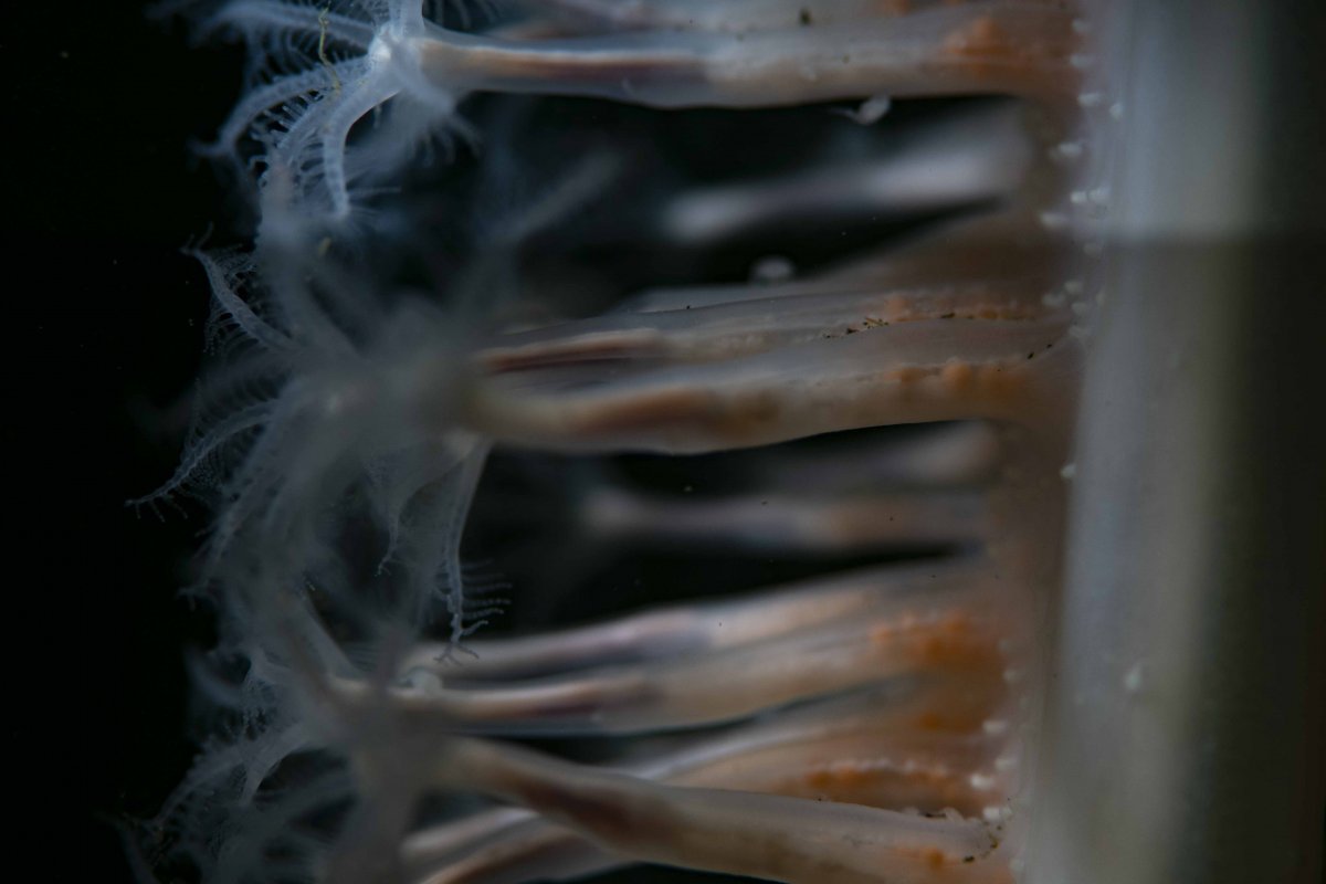

  1. Any advice here is appreciated. I just bought the retra snoot and am using it with a Sea&Sea YS-D2J strobe. When using it for the first time with a Nikon D-500 and 105 mm Lens in a Nauticam Housing the lower half of the photo is noticeably darker. I've never seen this before with my other homemade snoot. I'm also using a manual focus gear, but it's back away from the lens. By the second dive the dark area was shorter, but still present. Has anyone else experienced this or have advice about it?

  3. Tim, thank you for the thoughts on the Retra LSD. I'll try the higher output levels and ensure the alignment as you suggest. I also spoke with Backscatter today and they are suggesting the slide may have been slightly misaligned. Hopefully, all this will take care of the problems and I'll definitely try the smaller holes.
  4. Wow, yes, a slide misalignment would certainly lead to a blocking of the strobe light output.
    As I'm sure you have found, there is a definite "click" position once the slide is in the correct position. A couple of times I've rocked a slide to ensure it is in the right place - having puzzled over an under-exposure.
