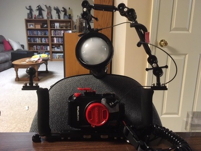

  6. Thanks for all the pictures and helpful advice.     I think I can manage to DYI a strap similar to the one pictured.     Great idea.     I was also thinking of using a Velcro strap to secure the Strobe to the tray to keep it from flopping (swinging) about.    It may be unnecessary but I was wondering if any one else does the same.     I have attached a picture.    What is not in the picture that I also have is a Ball clamp on the left tray ball attached to a 5" arm, clamp and focus light.

  7. It looks like you are using a single arm/strobe.  I would think you could more or less fold the arm down so the strobe is against the top of the camera and it wold stay.  if not, or if you just want to do do something different you can get some velcro industrial strength strap and use that to strap the arms9s0 wherever you need.  Just undo it in the water and attach to tray or wherever.  It comes in different lengths and widths and can be cut to whatever size you want.  I have seen it in different forms including "fast wrap" one wrap", etc.   I don't use it for that but do use it diving and it holds fine.
    Generally, I can clamp the arms in place for entries and exits, but the strobes hang down to the side of the housing and I use a rope grip, so gravity keeps stuff in place.  Your configuration looks like you might be working against the weight of the strobe.
