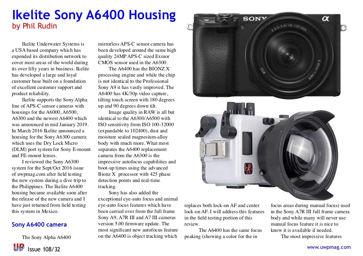

  3. I reviewed this camera in an Ikelite housing for issue #108 at uwpmag.com, free PDF download in back issue. The lenses I like most are the Sony E 10-18 zoom for wide and the Zeiss 50mm for macro. As stated above the 16-50 with a flat port and wet lens like the Nauticam WWL-1 is also an option. A very cheep solution is the Sony E 16mm with clip-on Fisheye adapter lens.
    The 18-135mm is an excellent above water/travel lens but not a lens that can be supported underwater.
