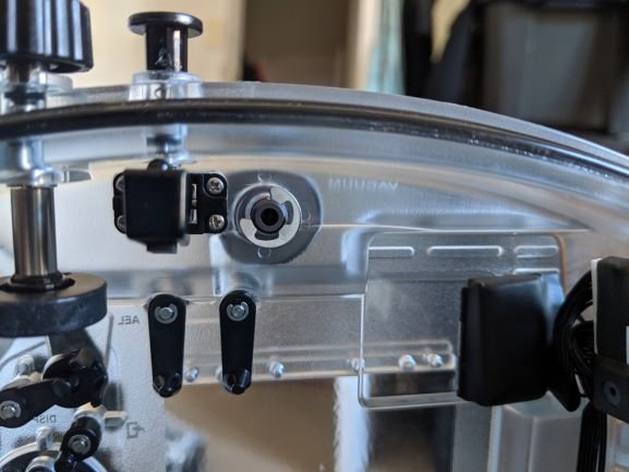

    I read that Fantasea are bringing out the FA-3 LED trigger which is compatible with the new housing,  so far it is not available yet in Australia.  Besides, I was bummed but the idea of having to spend another $300 for an item I already own that is now useless to me.  At first it appears to fit, but when testing I noticed that the addition of the vaccum system inside the housing (when closed) is pushing against the LED trigger and moving the camera slightly forwards in the housing, which meant that some of the controls weren't working.

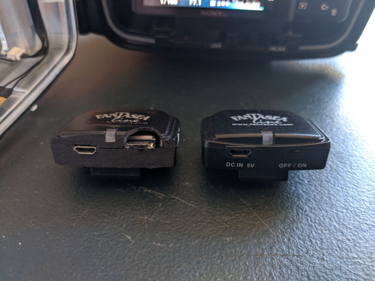

    Fortunately I had a spare FA-2 trigger that was giving me problems to experiment with.   Fantasea had kindly send me a replacement a year or two ago because I think I just got one with a factory defect.  I decided to try modifying the LED casing to make it fit.  First I removed the electrics and sanded down the back, removing about 1mm of the plastic.  This didn't work.  So using blue-tak, I worked out where the vacuum valve was pushing against the trigger's casing. (Should have done this step first!)
    Turns out it is just above the on/off switch on the trigger.

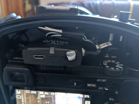

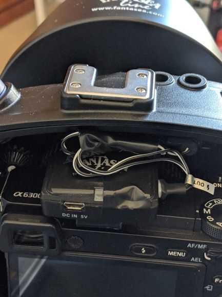

    So using a carpet knife and sandpaper, I removed some more of the casing.  After testing, I covered the hole with electrical tape to provide a barrier to dust and reseal it.  Works perfectly now.  FYI, you don't have to remove the electrics for this procedure, just remove the top cover.
