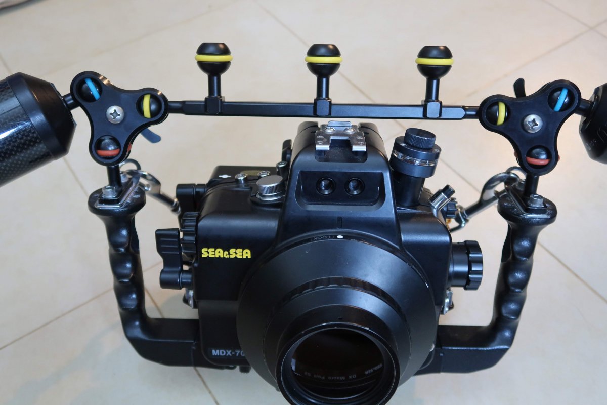

  6. Maybe this is a solution for your weak handles. It could make the whole setup a lot more stable.
  7. That's nice idea switchblade.  The horizontal bar must be customized though.
    The newer Nauticam housings have a customized stainless steel tab to connect top of the housing with the handle top.  I have been thinking about making something like that, but the housing lacks potential fixing point for it
  8. I don't think you will have to do that much customization. You really only need 2 tripple clamps and a ball arm of appropriate length. As you have a bit of play with the clamps it should be easy enough to find one that is the right length.
