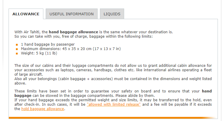

    where are you going? How strict is the carry on weight. In places like Indonesia my cary on has never been weighted despite the 7kg limit, its probably closer to 15+kgs.
  5. Going to Fakarava. I have never had an issue in Indonesia either but apparently Air Tahiti are super strict.
  6. One of the work arounds that I have heard of people doing is buying a large photography vest and placing all your lens/ports, strobes and accessories in it.  Then you can hand carry your housing. I have also seen photographers hand carrying their rig all set up.  By carrying some or all of your rig rather than having it in a carry on you are hoping that the airlines considers it a personal item and doesnt weigh it or weights it on your person.  Of course if you do this I would not carry a carryon bag as to not push it.
  7. I wish it was that easy. See below for carry on baggage policy

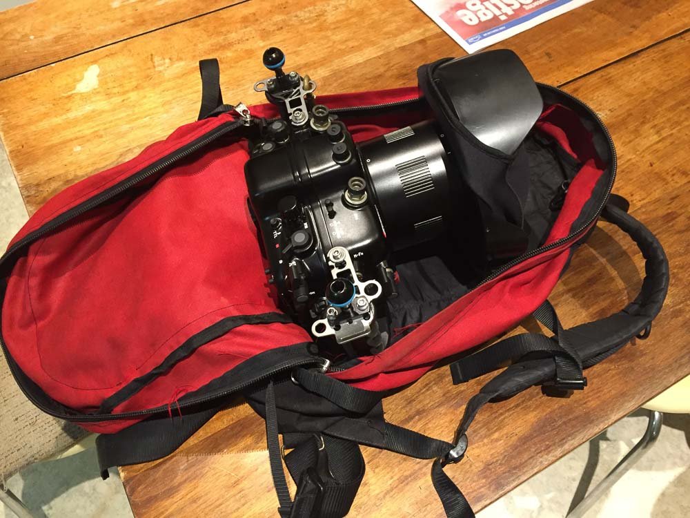

  13. I travel on ATR72s a lot. An Osprey Porter 46 backpack with fully constructed housing with 8" dome and four Z240s will fit sideways in the overhead. This same bag slides in end-on on a 737 or similar overhead locker. This is with just the housing in flat - if you stuff clothing/other on top of it then the bag bulges too much to fit.
    Of course it weighs 12kg with 5D4, lens, housing and strobes, so depends if they are weighing backpacks or not.
    Like this but I upgraded the bag to the Osprey which has much better padding and construction.
