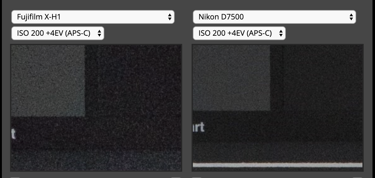

    The Nikon D7500 has a much better dynamic range and is less noisy, which in my opinion is much more important to get good pictures in low light situation where you cannot use a strobe. If you look at the comparison of dynamic ranges (https://www.dpreview.com/reviews/fujifilm-x-h1/9), you'll see that there is a huge gap between the X H1 and Nikon APS C, including cheaper models such as the D5600.

    As you can see, the difference is quite significant.
    The D7500 has a huge capability to recover underexposed pictures without adding too much noise. Between image stabilization and dynamic range, I much prefer a better dynamic range, which will benefit all pictures, even those where shutter speed is not an issue.
