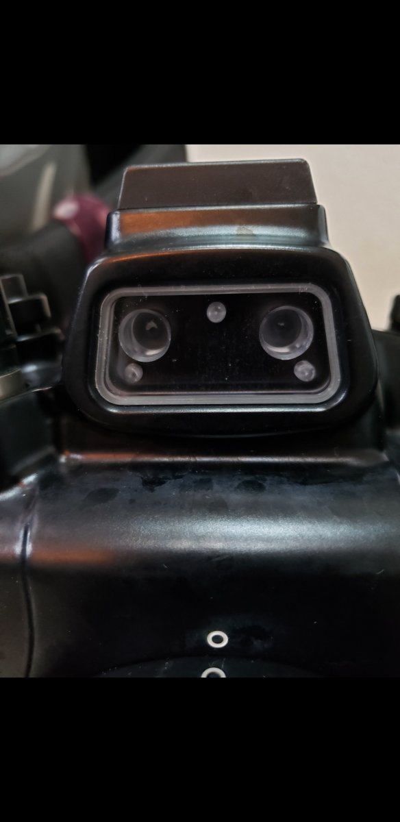

  1. HELP, I have a photo workshop in less than a month. It seems when only 1 side fires consistently and the other doesn't. I think it has to do with my left side, no flooding in housing etc. When I rearrange my strobes and cables the right side works fine but not left. Any ideas?

  7. Thank you all for your help and response. I have a gh5 in nauticam housing and use fiber optic cords. I have 2 sea and sea ysd2 strobes. Never had any issues before until testing my equiptment now. My camera requires a flash trigger and they both fire when I look at the camera (and when I have 1 strobe in it works fine which is why I thought it was a battery issue maybe? I have tried each cord for each side and each strobe and every configuration. It's always the left side. I wiped down each connecting piece to make sure everything was clean etc. Half of the workshop is wide angle so I obviously would love to have both strobes working

  14. Have you tried using a q-tip and cleaning the port hole where the fiber optic cable plug in? Might have some scuzzy in there. Also, fire the camera with no fiber optic cables attached and observe the ports. Is the flash equally bright on both sides?

  15. Yes I've looked thru my cables at eye level and the flash fires on both sides and I ordered a new battery cap and strobe and will just have the other one sent back. I've cleaned the contacts thoroughly etc. And trouble shouted with the shop I ordered with. Thank you
