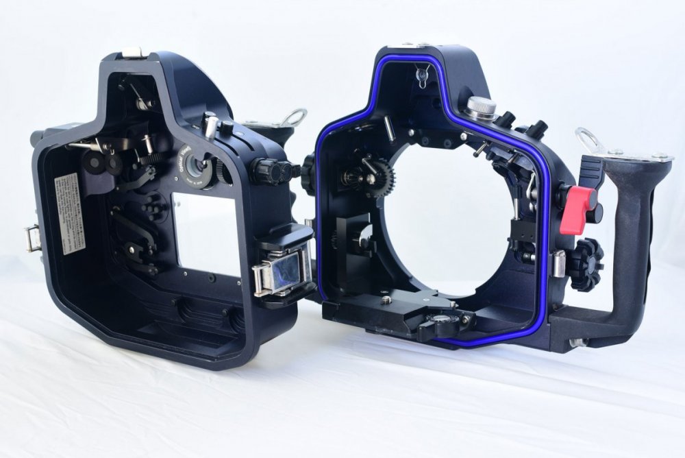

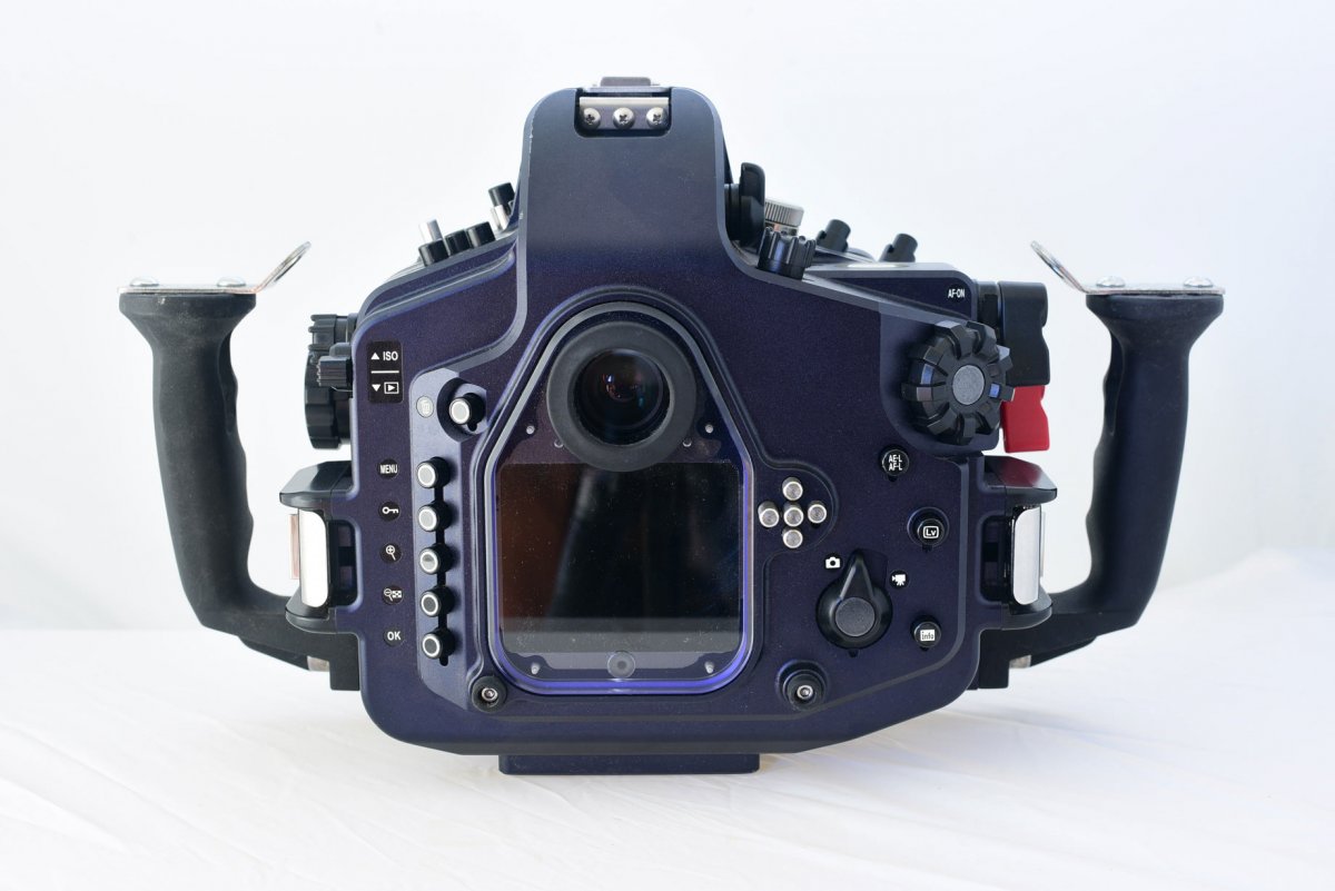

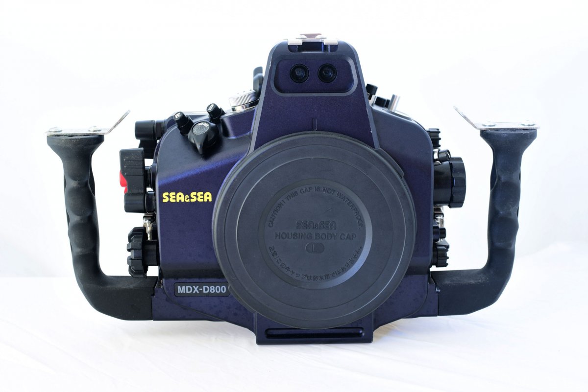

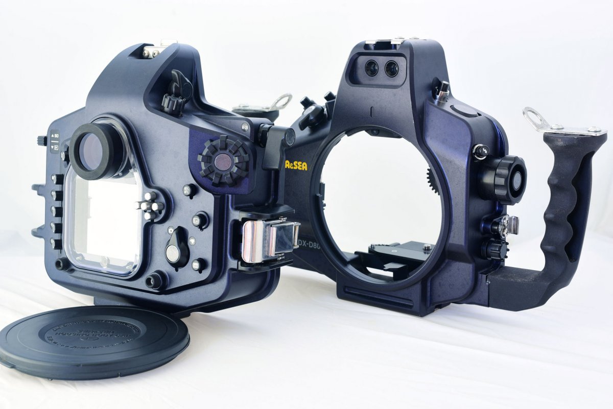

  8. @underwatermatt:
    I'm sitting on a Sea & Sea MDX-D800 in excellent condition. It's actually never even been in the ocean...Only the pool a few times. I bought the D810 when it first came out...But come my trip it was so fresh that no housings had been released for it yet. The D810 was so similar to the D800 that I gambled on buying the D800 housing in hope that most of the buttons would line up, which they did for the most part. But after I returned from the trip for which I bought it, proper D810 housings started becoming available and I opted for one of those and forgot about the D800 housing. And I didn't end up having the time to bring the housing into the ocean during the trip anyway.
    You can inspect the images I've attached. Please PM me an offer if you're interested!
