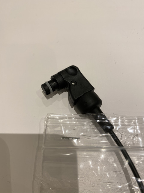

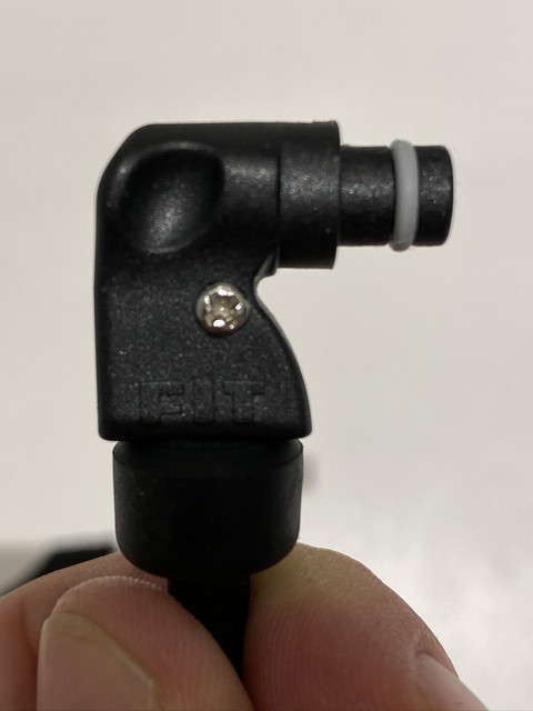

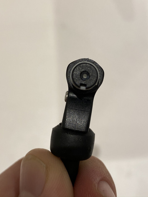

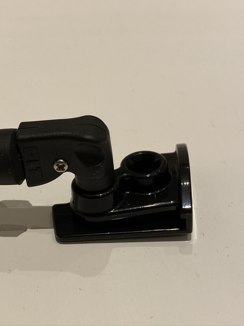

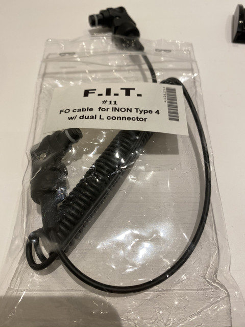

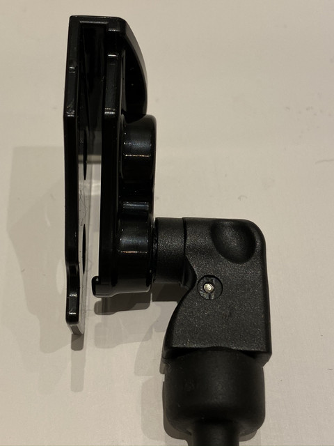

    Unfortunately it looks like I received the wrong fiber optic cables. I was told, and hence ordered Sea&Sea style fiber optic strobe connectors. What I received is in the picture below.
    I don't have any experience with these connectors, so before I try and sent them back, and hopefully receive the correct ones before I leave for my trip, can someone tell me if these will work as well? They connect just fine to the adapter for the Olympus TG-6 Housing, but seeing as I haven't received the Sea&Sea YS-01 strobes yet, I can't test the other side of the connection.
    Here are a few more pictures, the last two showing the fiber optic cable being connected to the housings adapter.
  12. Yes they will work, that is the type of connector used on S&S strobes hence the name.  Looks to me like these are in the wrong bag.  INON uses a screw fitting at the strobe end which is bigger than the connections on your cables.  This is the INON type connector:  https://www.google.com/url?sa=i&rct=j&q=&esrc=s&source=images&cd=&cad=rja&uact=8&ved=0ahUKEwjq5f72z47nAhUV8XMBHR62DakQMwiHASgQMBA&url=https%3A%2F%2Fwww.housingcamera.com%2Fid4748-inon-l-connector.html&psig=AOvVaw3B28qZu4oB4JX9C41NgsT-&ust=1579487590136915&ictx=3&uact=3
    which is not what you have.
