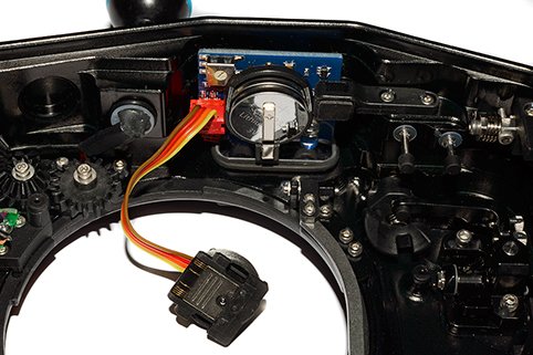

  3. Yes, UW Technics TTL-Converter #11073 installed in the housing, preserves pop-up flash functionality. Construction is made this way to expand the capabilities of synchronization system in the housing. SonyA6xxx-TTL-installed-17x11.jpg
