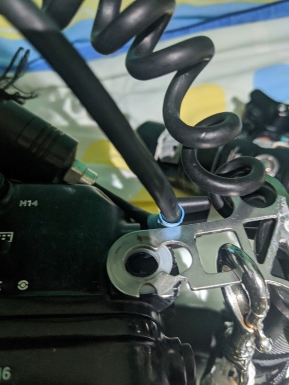

  1. I've got a Nauticam housing for my Canon EOS 70D and in the process of reconfiguring it slightly and have lost some original bits.
    Currently i have a ball mount for a gopro mounted which i want to remove.  The problem is, removing this requires some sort of reducer and screw to complete the housing setup but im unable to find the name (or part numbers) i need.
    This is the mounting hole with the  ball removed.
    The other side has a reducer of some sort and screw as can be seen here:-
    Basically im after the name and/or part numbers of these items (reducer thingy and screw so can order them and remove the unneeded ball mount.

  4. That doesn't look like a Nauticam part at least not for any housing I have used. As Bill1946 says, go to your local hardware store and find the size of screw that fits the hole. Then get a stainless steel one (316 is best, 304 is OK).
    Most likely it is a 6 mm screw size but might be 8.
    Bill
  5. Just use the right size bolt and flat washer in stainless steel.  They will be metric threads.

    The attachment is nothing but a bolt and flat washer.  I'd be surprised if could not be found nearby.  My guess looking at it is an M6 bolt probably 10mm long.  As a stop gap you could take the attachment bolt from the ball mount and cut it shorter and it would work even without a washer.
  8. I get your frustration. Can you find another person with a similar set up and try their bolt? The size MAY be stamped on a common item. If not, try to measure it in metric. If you can determine thread and length have anyone mail you one.
