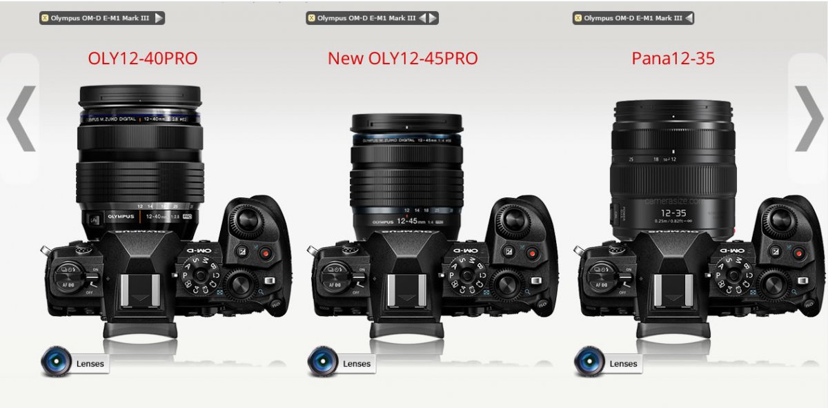

  1. Micro Four Thirds Camera and lens sizes comparation:
    Olympus M.Zuiko Digital ED 12-45mm f/4.0 PRO
    Olympus M.Zuiko Digital ED 14-42mm f/3.5-5.6 EZ
    Olympus M.Zuiko Digital ED 12-50mm f/3.5-6.3 EZ
    https://camerasize.com/compact/#840.852,840.409,840.332,ha,t

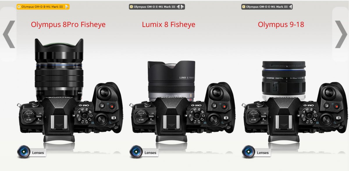

    Olympus M.Zuiko ED 8mm f/1.8 Fisheye PRO
    Panasonic Lumix G Fisheye 8mm f/3.5
    Olympus M.Zuiko Digital ED 9-18mm f/4-5.6
    https://camerasize.com/compact/#840.470,840.4,840.96,ha,t
    Olympus M.Zuiko Digital ED 12-40mm f/2.8 Pro
    Panasonic Lumix G X VARIO 12-35mm f/2.8 II ASPH. POWER O.I.S.
    https://camerasize.com/compact/#840.412,840.852,840.626,ha,t

    Thank you very much for your information. I'd like to see these specs in brand webpages, full sizes of short/long zoom
    This is the new comparation: http://j.mp/37tk0Sv
    Panasonic Lumix G Vario 7-14mm f/4 Asph.
