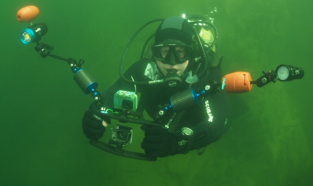

  5. In my opinion it's as important to balance the action camera rig as in case of a bigger setup, or even more important because the actioncameras in small housings are more dense and easier to shake. This is my current rig with 2 action cameras (yi 4K, firefly 8SE 90 degree) and 2 lamps. Besides the 2 floating arms I also fine tuned it with DIY modified bouys used for fishing nets as a very cheap (removable) option. You can see that the one attached to the smaller lamp was cut.
    Interesting, did you make a conscious decision to go with two different lights rather than a matched pair?
  7. Not really, it was more a decision, dictated by the budget (or luck of it). I've already upgraded the small lamp to a bigger one.
    The optimal solution is, of course, two identical lamps.
