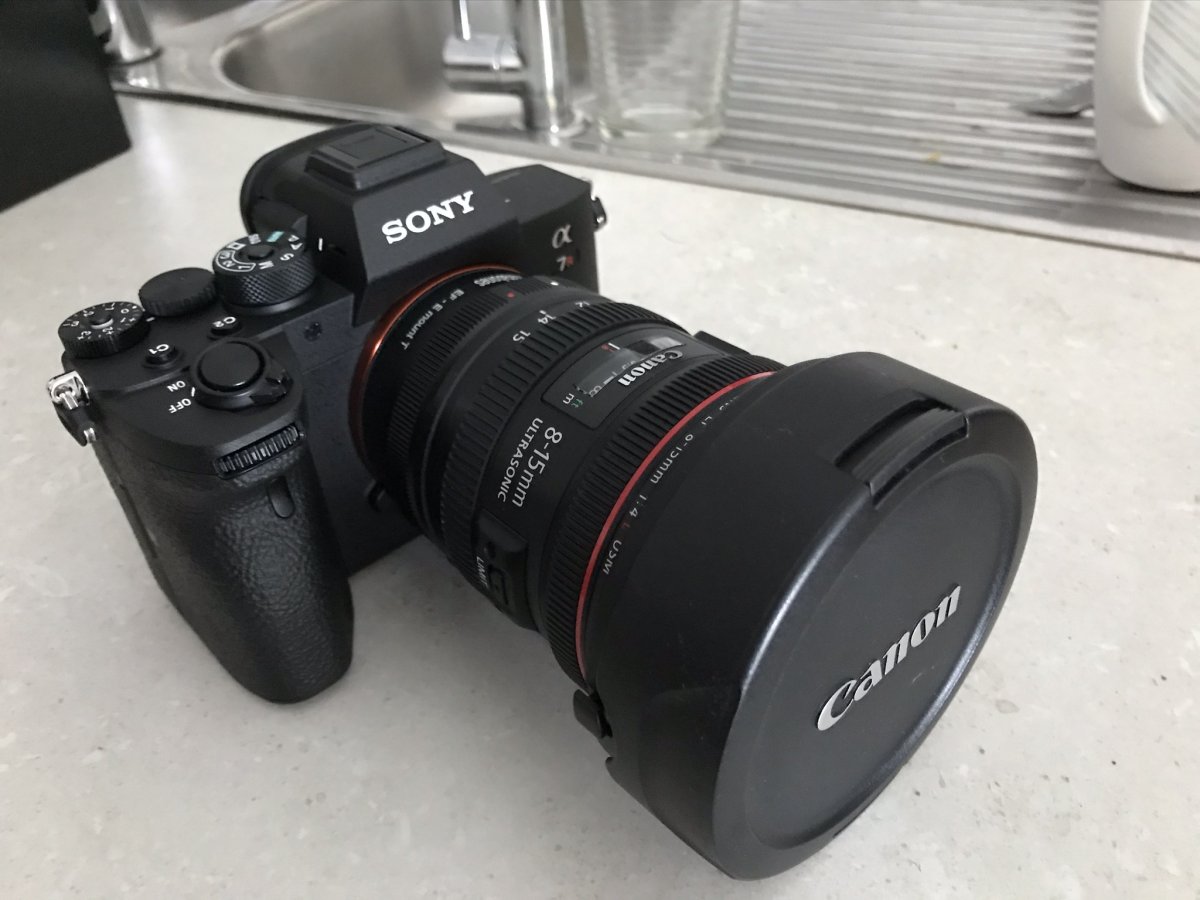

  3. I'm using a Canon 8-15 fisheye on a Metabones adapter with my A7Riv and am very happy with the results.  Looking at the Nauticam port chart for the Sony A series cameras the Sigma 15mm fisheye (Canon EF mount version) on a Metabones adpater is also an option:
    https://drive.google.com/file/d/19EjK3kbnhmJQU1pdDKr6XE6Lk3ykZpIT/view
