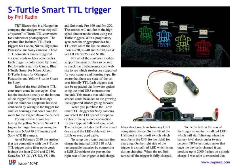

  7. Hi Thomas,
    Regarding battery life as with all batteries things are not always equal however during my tests I exceeded the specs. of 2000 flashes per charge by a lot. I also used the S-Turtle shooting models in the Mexican Cenotes at 5 to 10 frames per second and the S-Turtle was able to keep up without overheating or misfiring.
    If you would like to read my full review of the S-Turtle for Sony it is in the back issues at uwpmag.com, issue #110. This is a free PDF download and contains lots of useful info on how to use the S-Turtle.
    As with a lot of U/W equipment failures I ignored my own advice and managed to pinch the wiring for the S-Turtle when closing the housing. This was complete Pilot error on my part and no fault of the S-Turtle but resulted in damage to the wiring which has put the S-Turtle out of commission for the time being.
    I hope you enjoy my take on this excellent tool.
  8. Thanks Phil - I will find the #110 issue and read it :-)
