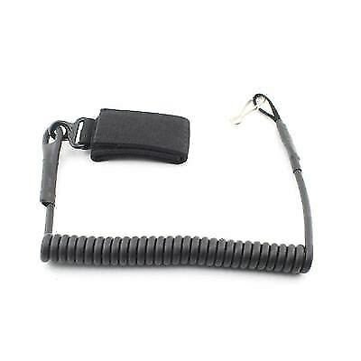

  2. I use a retractor, like the ones used for gauge consoles.  Once in the water, a system isn't (or shouldn't be) very much positive or negative, so a solution doesn't have to be very heavy duty.
  3. I have used a pistol lanyard for many years, works fine, and being coiled it stays out of the way.
    One costs about $ 7.- US in eBay
  4. I use one of those typical lanyard straps with a quick release buckle with one end clipped to a D-ring on my left side.  I've had the rig (negative buoyancy) dangle from the strap many times.
  5. Awesome, thanks for your help! Looks like I'll be buying one of those coiled thingies pretty soon then :)

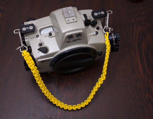

  10. 12 hours ago, robotr0n said:
    Just out of curiosity: What's the piece of rope (looks like it's about 5 inches long) connecting the two ball mounts for?
    That is a rope handle to lift the rig.  It's how it is lifted in and out of the boat among other times.
    Craig
    Here's another example of a carrying handle - it might be easier to see.
    They are really easy to make. There are lots of patterns on the internet and you need about 6' (2m) of paracord plus two stainless steel caribeners. It's a good stay-at-home project!

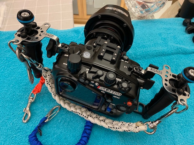

  15. I am not saying this is the best way or even a good way but I have used several variations of this over many years going back to film days. In the photo, my new rig (thanks to C19 it has seen no battle) you can see the blue Cetacean coil lanyard which stays clipped ALWAYS to my scooter ring (crotch ring). I only unclip here to hand the camera to a deck hand if I do not board with the camera myself. You also see the short orange lanyard with a bolt snap, this one is to clip and hang the camera rig off to my scooter ring for freeing my hands for minor, momentary tasks (not emergency). You see also on the left handle and right handle a screw link and the left one has a double ender bolt snap. Actually, I use two such double enders and these double ender bolt snaps stay clipped to my shoulder D-rings. They are used to tote the camera (beach diving) or to secure the rig to my chest in tight in the event I need my hands free to deal with an emergency or whatever. I can also clip the orange lanyard to my scooter ring for three point suspension of the camera rig (prevents the rig from hanging when in horizontal swimming position) or flopping around when walking to and from the dive site (beach dive). The white lanyard between the handles is used to lift or carry the camera rig. When in the water I may remove it and clip it off to my wing/BP (on a D-ring on my waist strap RH where some used to secure a can light). For beach diving or where I intend to not hand the camera off, I may dispense with the white lifting lanyard altogether.
    A variation I have used with smaller rigs is to use the white lanyard in place of the two double enders. In this way I thread the white lanyard through both chest strap D rings and then clip to the handles as shown or similar. Kind of resembles a sternum strap on a BC when deployed but for different purpose.
