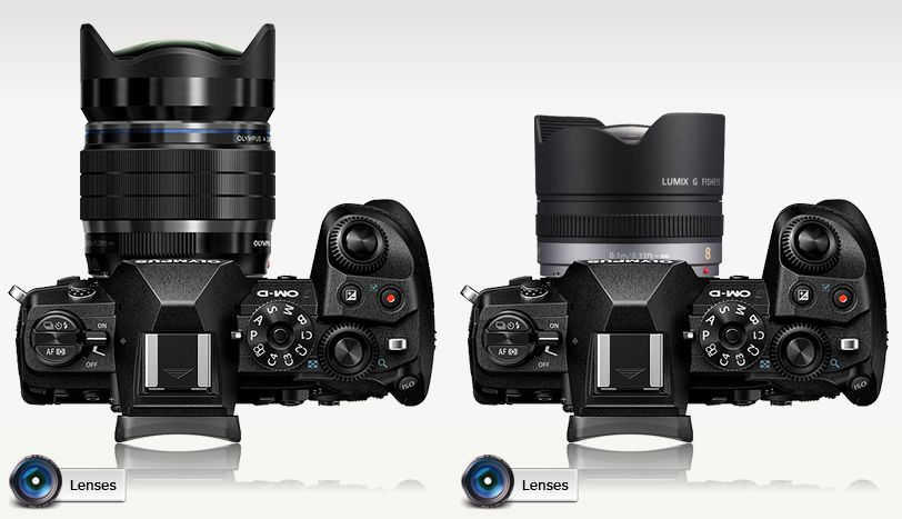

  1. Hi guys,
    I need your help. Has someone had the chance to compare those two Wideangle Fisheye Prime lens? I'm not sure which one will work better with a olympus 4/3 camera.
    Olympus 8mm F/1.8 Pro Fisheye
    Aperture range: F1.8 - F22
    Weight: 315 grams
    Min Focus Distance: 0.12m
    Angle of view: 180 degrees diagonal angle of view
    Panasonic 8mm F/3.5 Fisheye
    Aperture range: F3.5 - F22
    Weight: 165 grams
    Min Focus Distance: 0.1m

  4. Myh thinking the Panasonic is compact if you want to save money get it
    Olympus not much point by the time you add glass dome etc you may buy a metabones adapter and then choose a tokina or a canon fisheye so you will have zoom, this will give far greater possibilities that a fixed focus wont give you

    Rectilinear lenses are problematic. I have tried and tested them all the only one that meets my quality standards is the Panasonic 8-18mm in glass dome preferably. All the rest have a number of issues that I won't bore you with. Particularly I dislike 7mm lenses as they are too distorted at the edges and have all sorts of other issues also on land. You won't go past 110 degrees with those lenses due to optical issues and vignette at the end the 8-18mm with the correct extension will give you the same fov and better IQ. I am not talking out of phantasy I have spent months testing so when I say I am happy with the IQ means that is as good as it can possibly get period.
    On a prime fisheye I would always go Panasonic because is a smaller lens and uses a smaller dome. If I had to go Olympus I would go Tokina or canon because the lens is large and you loose the CFWA opportunity. The 8mm pana also takes the 3.5 minidome that will loose a lot of field of view but get you very close for WAM
    I have in fact sold my Panasonic and I shoot a Canon 8-15mm in a 140mm glass dome but it is practically full frame cost and more than APSC flexibility with a 8-15mm fisheye zoom on a metabones smart adapter.

  9. I have the Zuiko 8mm fisheye. In case you want to use the lens also above the water, I would go for Zuiko and pay the extra money. You can get the lens cheaper from so called "grey market" internet shops, as Panamoz or E-Infin, in case you need to save money.
    You can easily save the money for the focus gear, AF works very well with the 8mm fisheye (I do not have a focus gear for the 8mm Zuiko and I never regret)...
    In case you already have a dome port, you can try to use this one, even if it is not a dedicated fisheye domeport. I have e.g. the Nauticam 140mm (dedicated fisheye) domeport and the Zen DP170 (intended for rectilinear WA lenses). Both give brilliant IQ, the DP170 ist just bigger...

  11. I have the Panasonic 8mm fisheye used with an EM-1 MkII.  Nice lens, though I did find that there was some purple fringing in the far corners. Initially I thought it was also a little softer but later decided it was an issue with where I selected focus.
    Regarding the purple fringing I started this post:
    View archived post in: Purple fringing with Panasonic 8mm f3.5 lens on Olympus body
    It is mostly correctable with manual correction in my raw converter (Capture 1 pro).  Personally now I would spend a few more $ for the olympus which does not seem to have this issue.
