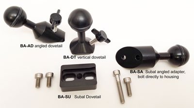

     My second question what fitting at the camera end is required for arms to be fitted, on all the pictures it looks like a flat plate, so its like the standard slide fitting.

    For the arms, this looks like a standard "bayonnet" or "T mount", for which you may get:
    https://www.carbonarm.com/en/balls-and-terminals/71-starting-bayonet-ball-0806808286574.html
    https://www.flex-arm.com/en/components/ball-and-adapters/1-inch-ball-with-universal-t-mount-60027bk

    For the strobe arms I would suggest studying the Ultra Light Control Systems on-line catalogue.  Their 45 degree slide-on ball mounts work well. You might consider some float arms. A ball mount for the finding light at the top center of the housing is quite useful:  https://www.ulcs.com/index.php/products/slr-camera-housings
