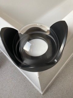

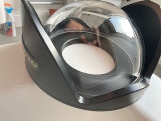

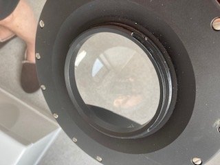

What type of Subal Dome Port is this ??
Started by B Harris ·
  1. Hi,
    I have just picked a Subal ND20 Rig and I am trying to identify exactly what of Type 3 Dome Port I have.
    Its 9cm (3 1/2") high and the diameter is just over 18cm (just over 7").
    Any assistance would be appreciated.
  2. Hi, it looks like a Subal 200 mm, 8 inch port.  I too got this dome port, in perfect condition as part of a Subal ND20 rig, together with its extension port.
     http://www.subal.com/a134c15c13/Ports_Gears_Viewfinders/Dome_ports/DP_230_dome_port.aspx
    I believe the Subal name for this port is something like the 8 or 8.25 inch dome port.
    From time to time eBay sells the Canon C20 (?) camera body for next to nothing, to complete the camera-housing package. I have yet to dive with it, will have to wait until the Corvid epidemic quiets.
