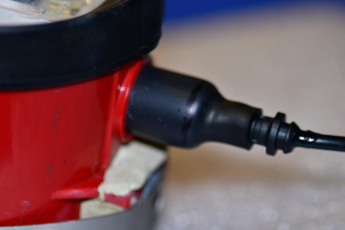

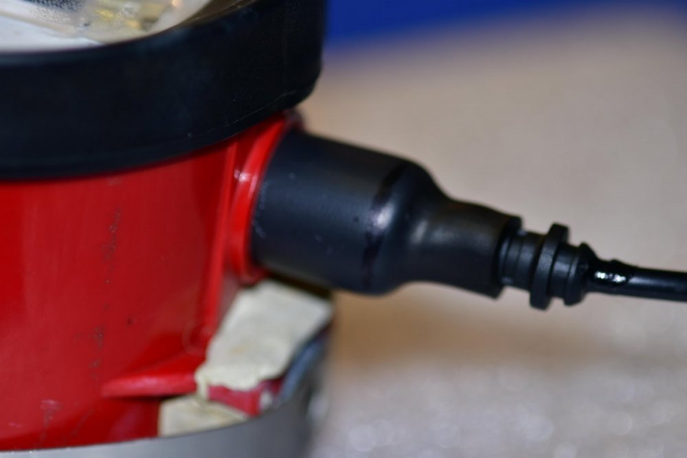

  7. Or you can make your own fiber optic cable to Inon strobe adapter for a few pennies out of heat shrink tube. The Wetpixel post with instructions is here:
     https://wetpixel.com/forums/index.php?/topic/60564-diy-fiber-optic-writeup-with-parts/page/2/&tab=comments#comment-413280
    The adapter can be made of heat shrink, electrical insulation tube from the hardware store in a few minutes. I have used these adaptors for many dives with Inon D2000, Z240 types 1 to 4 and Z330 strobes. I carry a spare, just in case. Inexpensive, works perfectly, and easy to replace.
