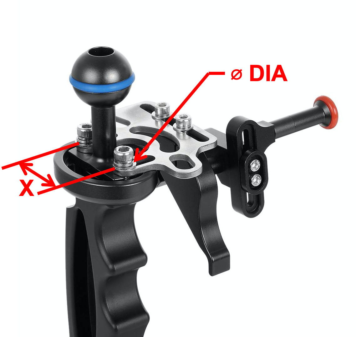

    I have a Nauticam Flexitray II and want to install a trigger mount. However, since I don't have a Nauticam housing the Nauticam brackets won't work. I am looking at third party options but don't know if those options are compatible with the Nauticam Flexitray II.
    Would like to know if the Dimension X and the Screw Diameter here are standard?
    Aaron
  2. The trigger is setup to work with the flexitray and bracket - housing is not relevant apart  from whether or not the extension will reach the shutter release on your housing and the fact that you don't have brackets if you don't have a Nauticam housing.
    However, Nauticam offer a universal RH bracket to allow mounting of the trigger:  https://www.nauticam.com/products/universal-right-handle-bracket-for-use-with-25200 if you don't have a set of housing brackets .  For a Nauticam item it is surprisingly cheap.
    Note this is for the Mirroless/compact housing shutter release extension which looks a little different to the one in your pic.
  3. Thanks Chris,
    I did not realize they had that universal bracket, I will get that instead.
    Aaron
