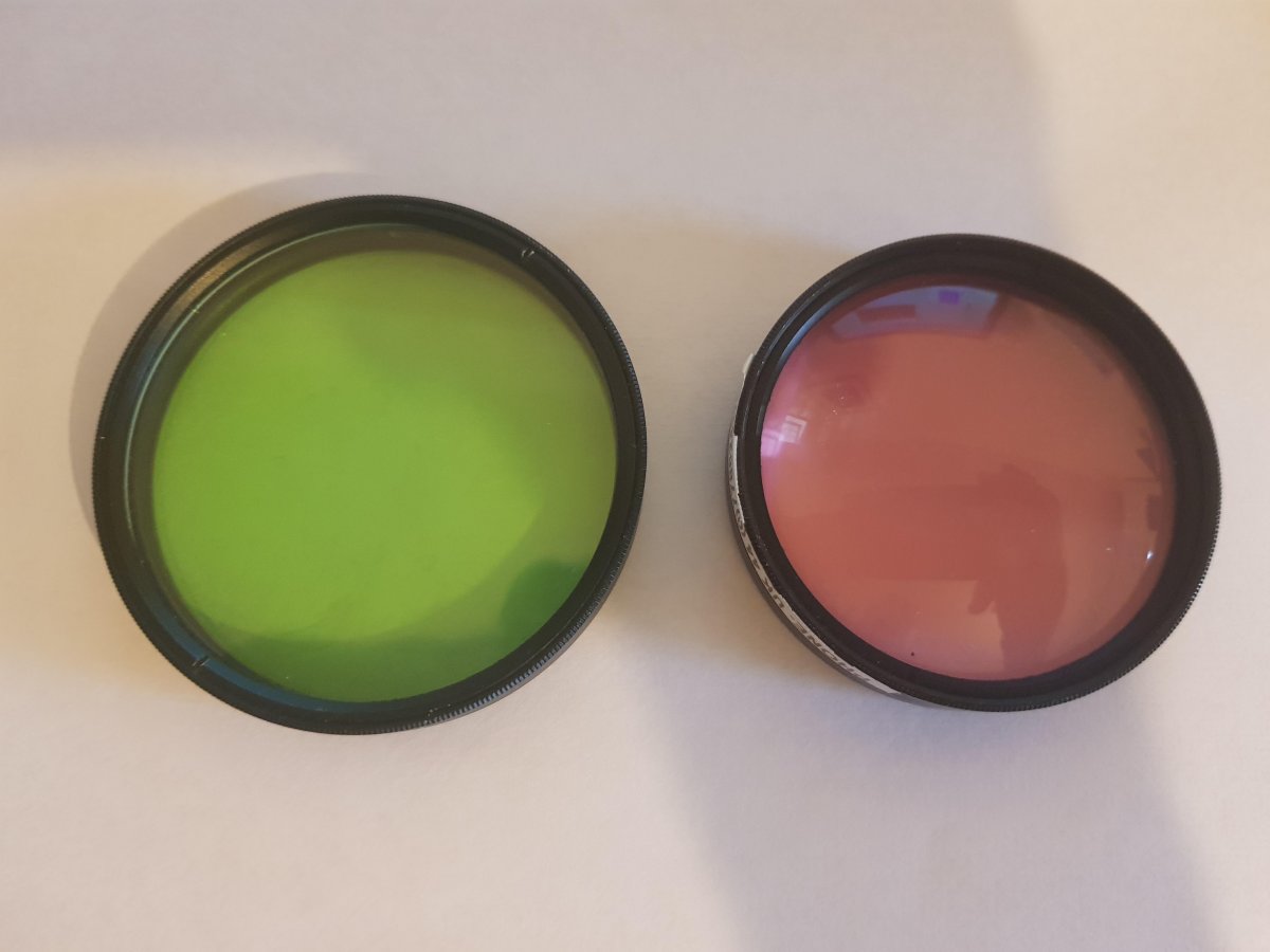

    I have tried and used a 58mm Kood magenta filter (sold for green water correction)  on my Gopro (easier to play with for now) and matched it to a Lee Plus Green 244. With that on the  video Lamp and Kood Magenta on the camera,  it worked well in practice. (I use this currently)

    The nearest Lee (Magenta type colour) to match the Kood magenta that I could find, is Lee  Pretty N Pink 794. This is very slightly more dense than the kood. This means the Lee Plus Green 244 wasn't quite correct to balance for ambient. The Lee Pale Green 138 matches the Lee Pretty N pink 794 spot on.

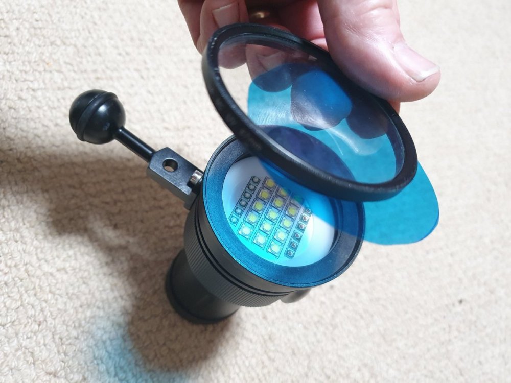

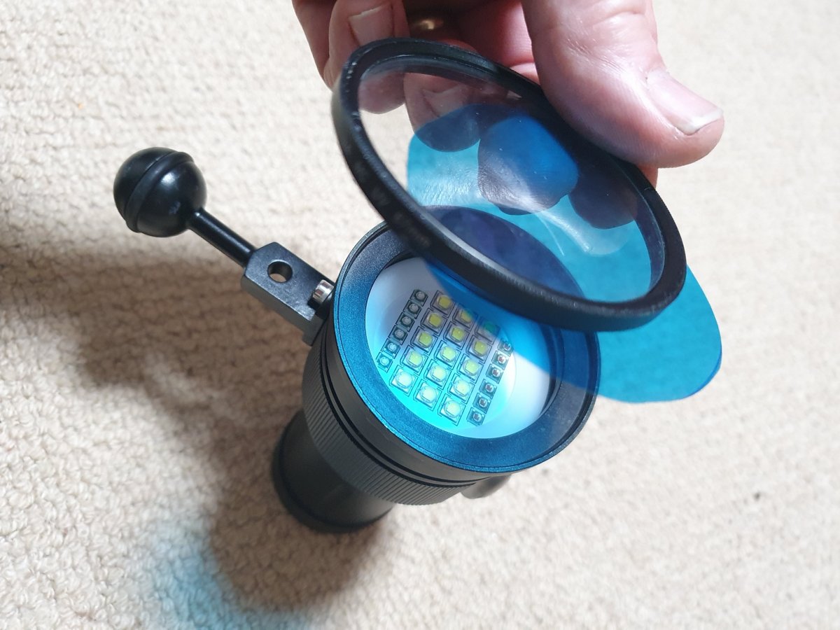

    I made up gel holders using two 67mm UV fliters and put the gel between them. Drilled vent holes so they flood ok. The filter screw onto my lamps. I fixed 67mm mounts onto the lamps.

    Pic shows the camera Kood 58mm magenta, and the lamp green Lee Plus Green 244

    I've glued  step up rings onto the front of my video lamps, they then have 67mm threads on the front, I put a gel behind a UV filter to hold the gel in place, drilled small holes in step up ring so air trickles out. ( or just unscrew at start of dive to fully flood it. PM me

  7. Image shows UV filter used to hold in gel to video lamp
