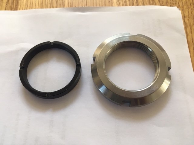

    Good news and not so good.  The bearing locking ring arrived this morning, and has the correct thread size.  That's the good news!  However, it is a lot chunkier than the original - see the photo for comparison.  Depth should not be a problem, but the outside diameter is just a bit too big to fit inside the window space.    I have a small lathe, so a bit of machining is required!
    Thanks again for the offers of help and advice.  Pete

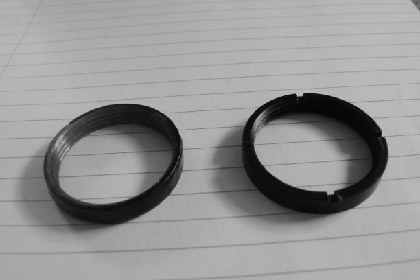

  13. The finished article.
  14. Wow, well done! :good:
