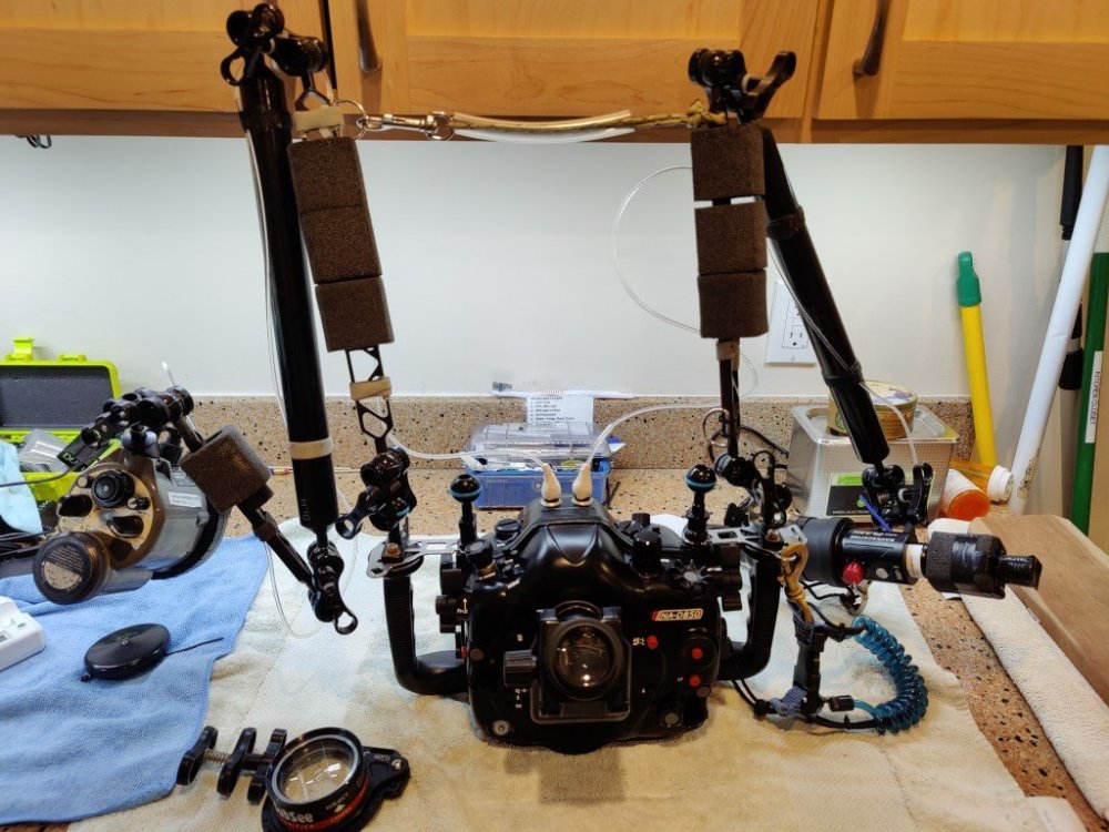

  6. I learned a lot from Richard Salas, and his #1 mantra is "Long Arms". Having long reach means that you can get a strobe behind your subject and back or side light it easily for more dramatic effect.  I pretty much use the same set up for both Macro and Wide angle, and the long arms have big advantages for both styles of shooting.
    My current setup is 16" + 12" + 8" on the left and 16" + 12" on the right.
