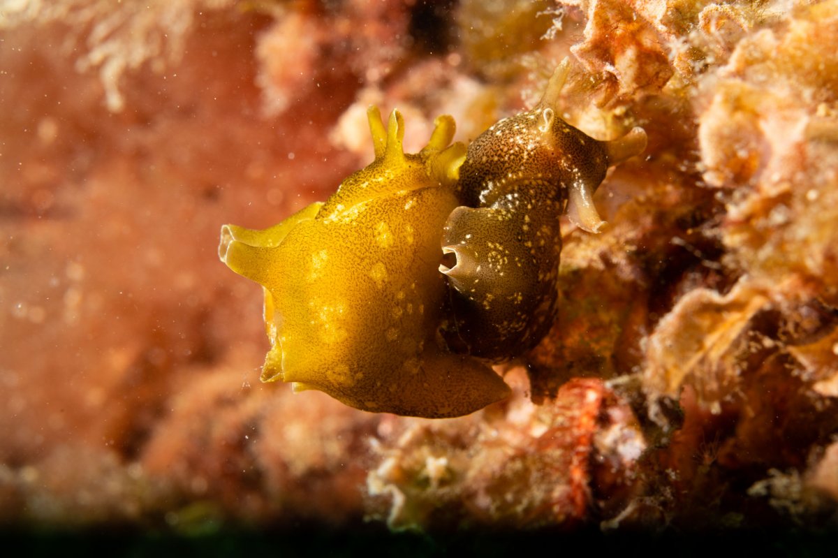

    I've been doing my first dives with my new rig. Relevant for my question: Nikon Z6, Sea&Sea housing, S&S TTL trigger, 2 x YS-D1 strobes. Mostly it went fine but I do have an intermittent problem, showcased by the two attached images. A shadow region in the bottom of the image with strobes firing.

    It does vary with shutter speed. The broad band occurs at 1/200 s shutter speed, which happens to be the max sync of the camera. The thinner band occurs at 1/160 s. This is not 100 % consistent, I have one 1/200 s picture with a thinner band. But when the dark bands occur they are always at the bottom of the image and almost always with these sizes for the respective shutter speeds.
    My hypothesis is that somewhere in the strobe firing chain (camera - TTL trigger - strobes) something misses the timing, so the the physical shutter is blocking part of the image when the strobes are fired. Since both strobes appear to be affected and I've never seen this on land I'm tempted to blame the TTL trigger. I have the camera set to rear curtain sync. It seems the strobes fire a bit early.
