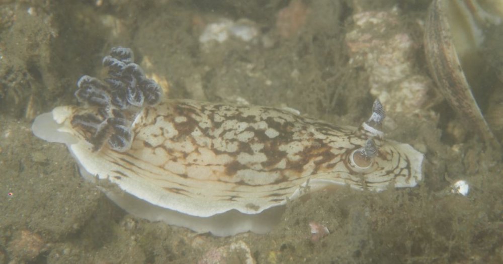

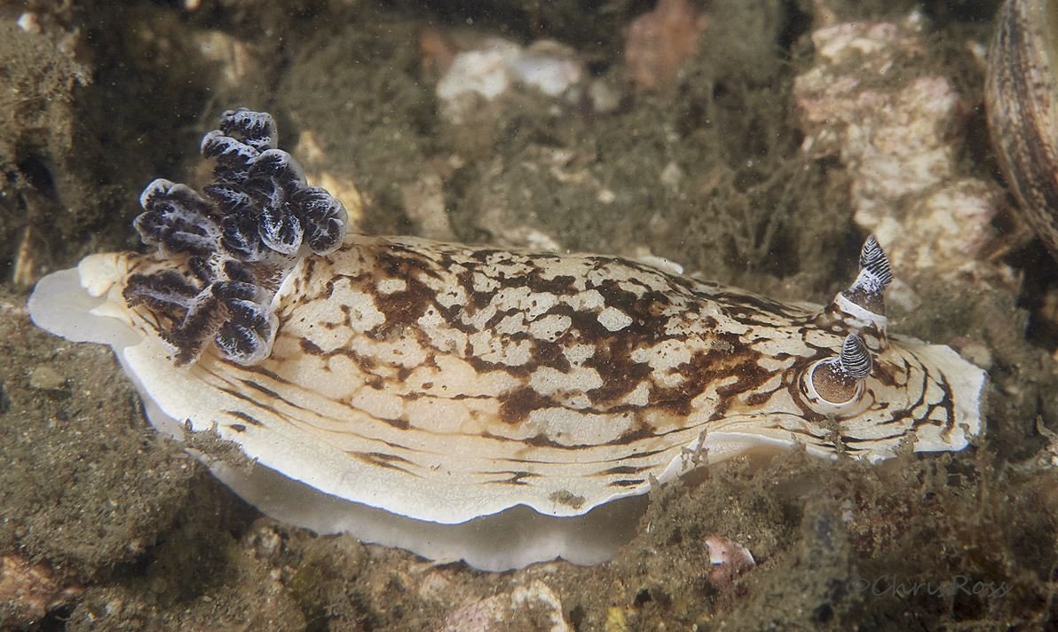

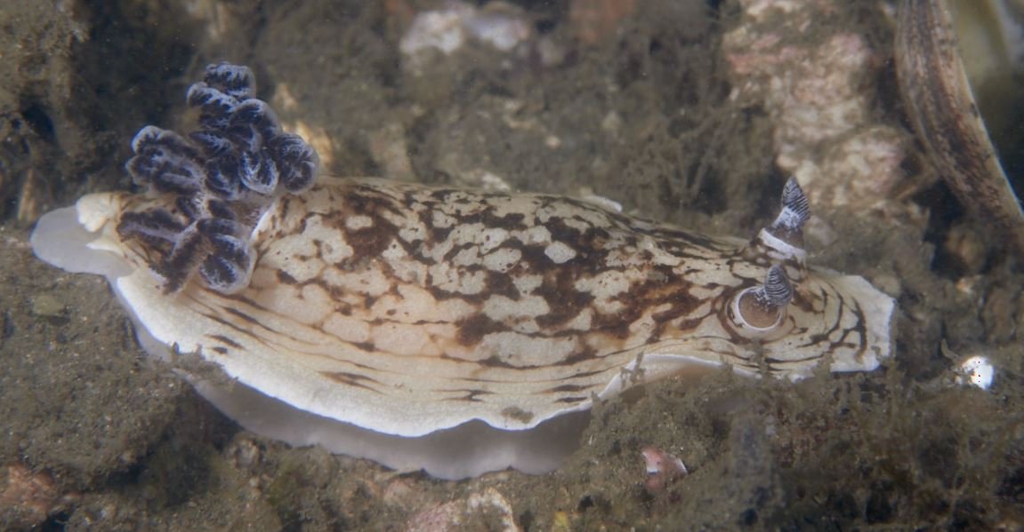

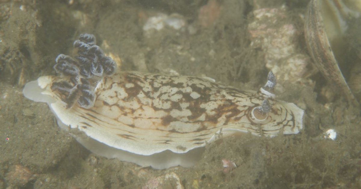

    To give you an example - this is not a great shot - tonal range is pretty limited , flash should have been a touch stronger etc. - just a nudi at Clifton Gardens this is taken straight from the Raw file and the only change is a levels adjustment that took literally one minute.  To finish it off I would fine tune the colour a little further and boost contrast with curves, sharpen etc.   But the point is to show how efficient the levels tool is.  The final file is a quick 3 minute final edit - I didn't bother with backscatter, just fine tuning the levels again and curves with tonal masks then out put sharpening.
    While you can make selections in PS for local adjustments - I'm not a big fan of that as it is often difficult to blend the adjustment in - masking is a much more powerful tool - you can use the image itself to make a mask for tonal adjustments and this is a perfect mask - the only thing I tend to use selections for is sharpening only the subject.  Masking also comes into play for backscatter removal and the right technique can in some cases do a better job than the healing brush.
