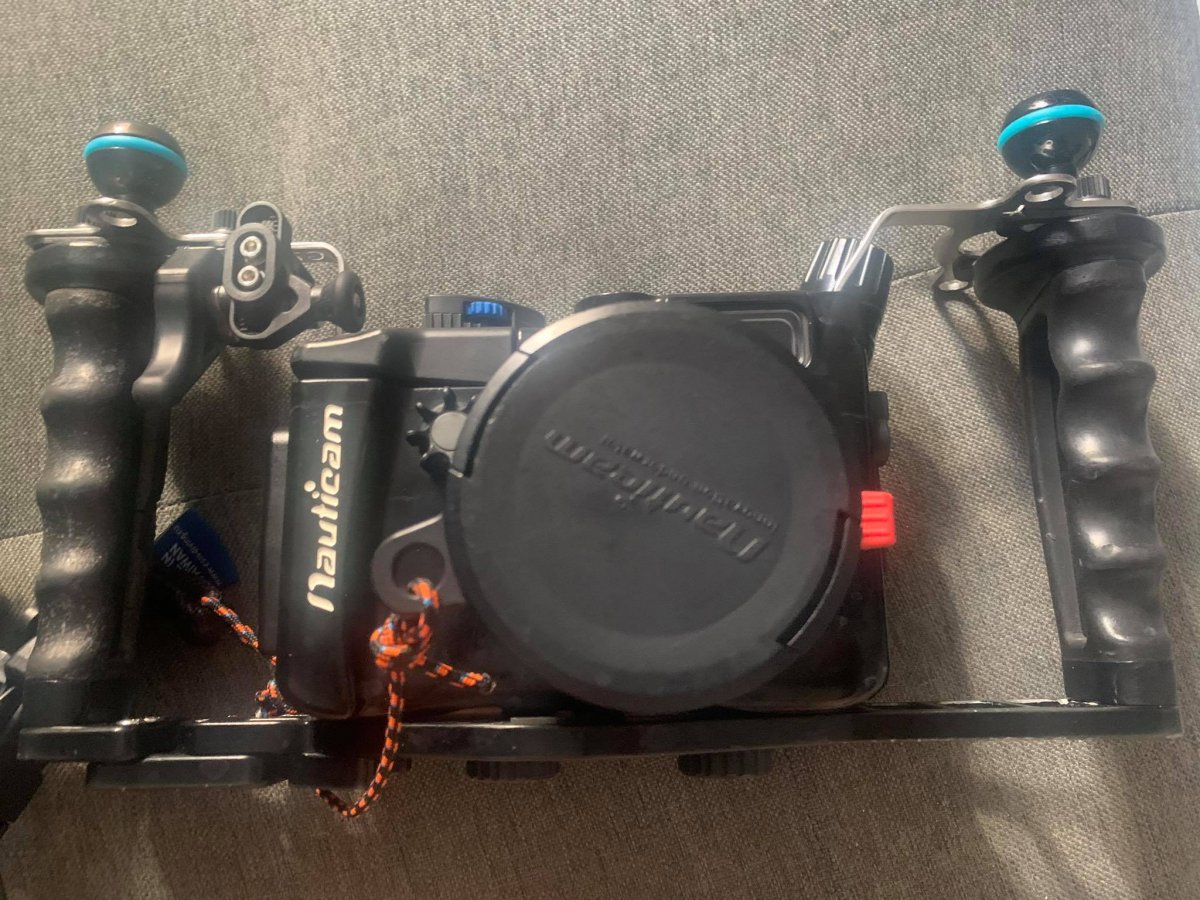

    I'm wondering how can I have a neutral bouyancy of my setup without arms. I'm using the vaccum system so it's very negative actually. This is a photo of my setup :

  2. Unless your name begins with ‘A’ and ends in ‘medes’, you may struggle.
    But seriously, you need to add something with positive buoyancy. That might be in the form of ‘stix’ style foam or a bouyancy arm. You could attach an arm between the two posts rather than sticking out to the sides.
  3. Pardon the obvious question, but if you’re not using strobes or lights, why use a tray and handles?  Ditching those would significantly reduce the negative buoyancy, with little effect on stability.
    Otherwise, spend $30 on some Stix jumbo floats and experiment with zip ties on the bottom of the tray.
  4. The vacuum system actually has no significant impact on buoyancy - this is set by the weight on land and the volume of water displaced by the housing.  If you ever plan to add strobes buoyancy arms will not be a regret purchase, I use a couple of my strobe arms attached with clamps between the two balls when I use my housing snorkelling .
    Removing the tray and handles will approximately increase buoyancy by around 60% of the  weight of the components removed, based on being aluminium.   Probably little impact of removing the tray for photography, but I imagine video would be easier and more stable with the handles.
    You could start with two clamps and a long arm running between the clamps to provide an attachment point for floats - or use float arms. You want the floats above the housing otherwise the housing will tend to twist upwards - with the float on top the heavier housing will hang underneath.  With float arms you need to weigh the housing underwater to know what size to buy - you do not wat to go positive, having the housing slightly negative is much more stable.

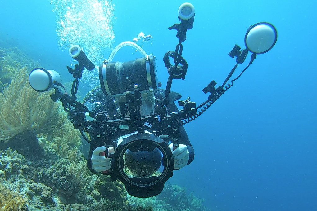

  5. I put a buoyancy cylinder (PVC from the hardware store) on a ball joint centered on a bar that runs above the housing from my two handles. The nice thing about the ball joint is you can adjust the tilt of the housing to match where you are shooting. Buoyancy arms are nice for making the rig neutral in a certain position, but when you go to shoot down or up you are fighting the buoyancy to do so. Photo of the rig below.
  6. Alright thx to all of you guys. And yes, the reason why I'm using handles without arms it's because it's more stable for the video and I'm currently a videographer in a dive center.
