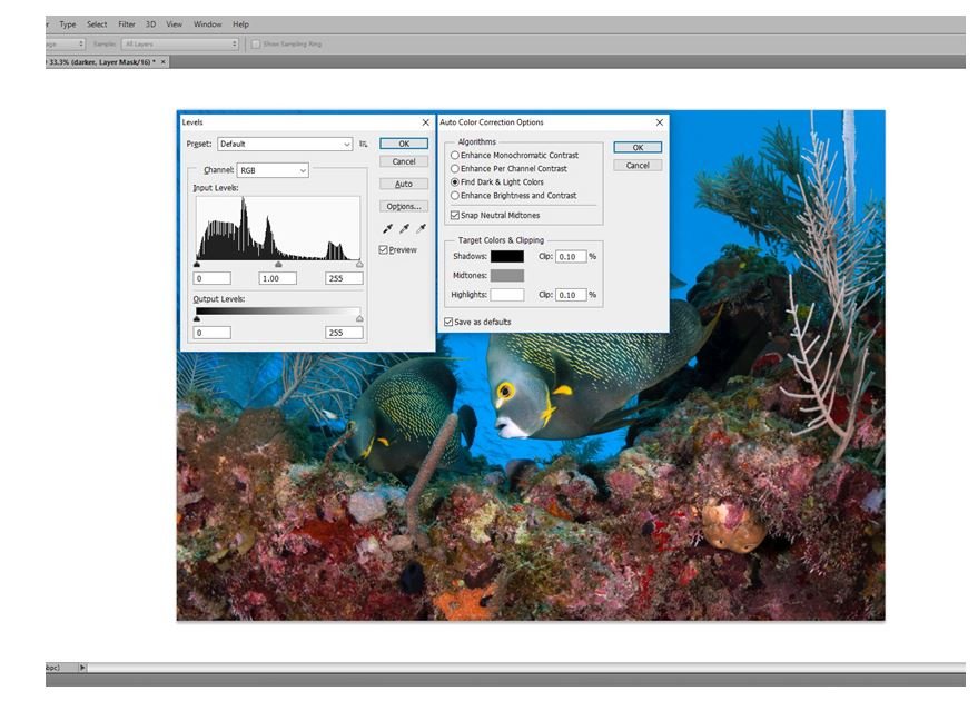

    I agree with you. Despite the effort to complete as much editing as I can in the raw converter, I still use the PS as a final editing stage, especially when I want to have a hard copy.
    One of my first tasks in PS is to try to improve the WB and contrast using levels. I pre-set the shadow/highlight clipping, also the algorithm is set to find dark/light colours and then I usually hit the auto in levels. If the result is not satisfying, I play with the individual colour sliders until I am happy with the outcome.
