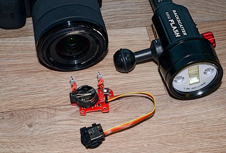

    MF-1 requires some more optical power for control than some other strobes.  Buy this reason, for example, UWTechnics updated all their TTL-Converters, - specially for Backscatter MF-1 strobe better support. Optical power and pulse duration in M mode has been increased in all circuitry produced since September.
