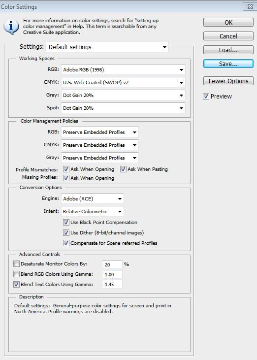

  16. Photoshop can do a lot of things with colour management and can get you into trouble if you are not careful.  The basics are:
    • Select the colour space you want to work in - in ACR you click on the link at the bottom that says something like AbobeRGB(1998) 16 bit etc and select your preferences
    • I recommend AdobeRGB1998 16 bit and 300 ppi resolution (only matters for printing)
    • In Edit Colour settings  use the attached settings
    This will set your working space to be Adobe RGB and PS will warn you if you open a file tagged with a different working space and you have the option of converting to working space.  Always edit in 16 bit it is much less prone to banding.
    For detailed explanation of what happens in colour management this is a good article:  https://imagescience.com.au/fundamentals-of-digital/01-digital-imaging-fundamentals
    I work in AdobeRGB and only convert to sRGB for an image  I am posting on the web.  You can soft proof your image using profiles from other devices, for example you can soft proof prior to printing.  This article explains how to:  https://imagescience.com.au/knowledge/using-icc-output-profiles
    Oh and all this relies on having a well calibrated monitor.
