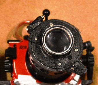

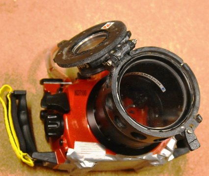

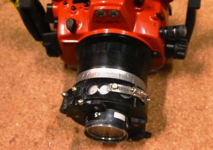

  5. I too had a flip macro lens holder with 3 screws to hold it in place, but as it tended to get loose, I made my own out of ABS plastic sheet, a short length of 10 cm (4 in) ABS drain pipe, and a 67 mm lens holder, plus a few s.s. screws and ABS cement. ABS is easy to work with, much like wood, ABS glue melts (welds) the parts together, and ABS is of almost neutral weight in the water. This holder has worked well for several years.
    I built mine with standard hand tools, drill press, adjustable hole drill bit, electric saw, plus supplies from the local plastic and plumbing store. The hinge, shaped like a standard cabinet hinge, was a tad difficult as the holes for the hinge pin were sloppy; I simply filled them with slurpy ABS glue along the pin, with suitable masking, and that solved it.
    For the diopter I used a 67 to 82 mm step-up ring glued into a suitable hole in the flip lid with ABS/acetone slurp.
     https://www.amazon.com/Sensei-67mm-Lens-Filter-Step-Up/dp/B00AE1M6NE.
    To lighten the weight, I drilled as many large holes as I could.
    This lost Subsee macro lens was found on the bottom of Balayan Bay (Anilao) by Peri Paleracio, who kindly gifted it to me.
    The holder is secured with a stainless hose clamp.  The duct tape is to
    protect the Subal port and housing.

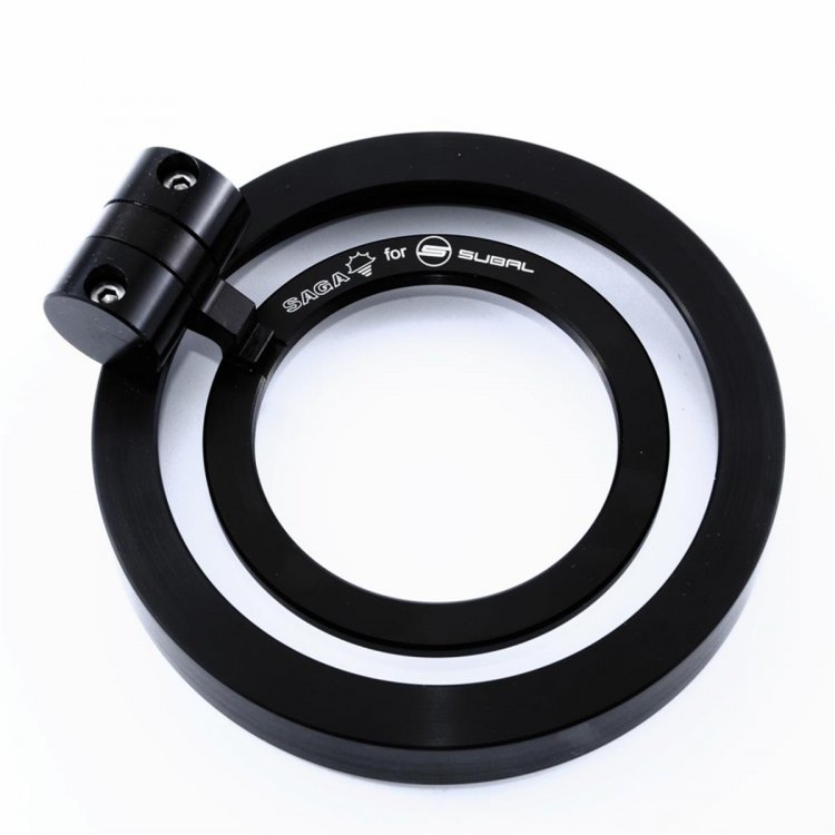

    Saga also makes a lens holder for Subal, secured by the pressure of an O-ring inside the large ring. getImage.thumb.jpg.765a163075dd999998268bcd3d4a77a6.jpg

    How does the Saga one actually fasten on to the port? I’ve seen them on websites but couldn’t work out how it is secured to the port.
    The idea of building something is quite tempting......  :yahoo:
  7. Hi, Tim:
    I have not handled the Saga holder, but the photos show it uses an O ring as a friction fastening.  Backscatter lists a Saga double flip lens holder for $250 US plus tax and shipping:
    https://www.backscatter.com/SAGA-M67-Double-Flip-Lens-Holder-for-67mm-threaded-Ports
    ReefPhoto has a nice assortment of lens holders, new and used, by Nauticam, Saga, etc:
    https://reefphoto.com/pages/search-results? diopter+lens+holder&type=product.    Kevin Palmer is most helpful.
    Please keep us posted and best of luck!
    Edited by Kraken de Mabini
  8. Thanks for that. Clever design, KdM.
    So Saga uses an o-ring eh? That doesn't sound hugely secure either? Maybe the one drawback of the Subal FP-FC port is that it isn't threaded.

  13. To secure the Subsee adaptor to the Subal FP-FC port I suggest the following:
    Wrap duct tape around the front of the port until the Subsee adaptor fits securely on it. Tighten the three securing screws.
    Thread a piece of stainless wire between the tape and the port, lengthwise to the port.
    Twist the ends of the wire over the adapter to secure it in place.  Use three lengths of wire, spaced evenly around the port.
    This way the Subsee will be held in place by its three built in screws, its tight fight over the duct tape and port, and the three wires.
    Materials: duct tape, stainless wire; tools: wire snips, scissors,  patience.
