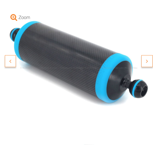

    However , I think Nauticam diameter 70 x 250 mm carbon fiber floats x2 (buoyancy = 520 g each )
    are the nearest neutral buoyancy for my setup.
    Please let me know your thoughts and suggestions.
