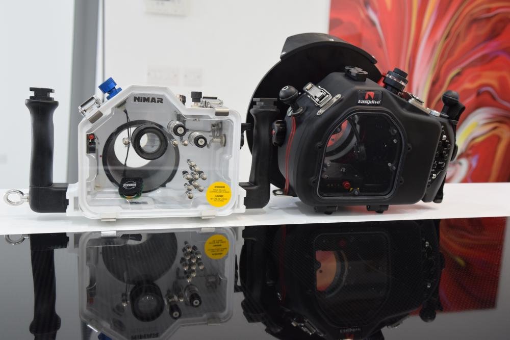

    Here's a size comparison between the Nimar and new Easydive.  The housings themselves are about the same size, although the Easydive is much heavier being made of aluminium instead of plastic and anxiety.  In the Nimar, the camera is connected to a plastic plate that inserts into the bottom.  In the Easydive, the camera is connected to the baseplate seen in the following.  Here's how the inside looks with the baseplate removed and battery disconnected (but standing alongside its slot).

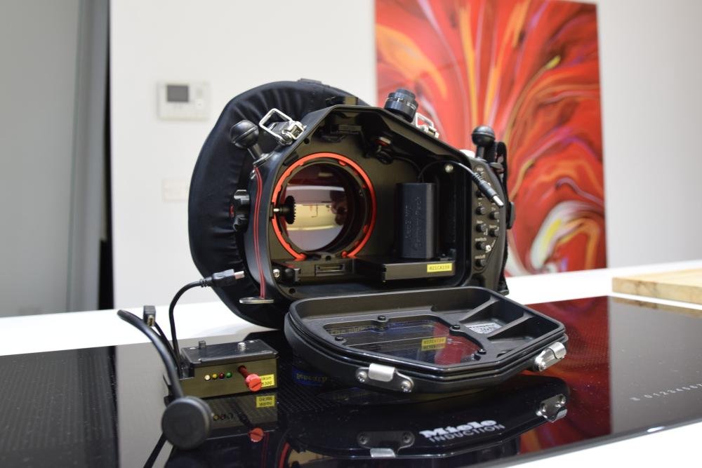

    When assembled, the camera goes on the baseplate, which inserts into the bottom of the housing.  The battery is placed against some velcro on the right and plugs below.  The camera connects to the housing computer by the two cables, with the third being the flash trigger.  (I think it can handle the internal flash, but haven't tried.)
    The buttons on the right side are used to interact with the camera.  For my D5300, this includes the important aperture, ISO, shutter, and AF modes.  Other models (like the Sony) have more functionality.  The shutter release is another button on the front.  All are easily operable with 5 mm wet gloves and dry gloves.
